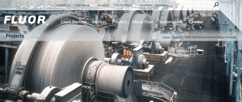

I worked on a number of autogenous mills. (Ball mills without the balls)
Each mill driven by two 3000 HP WRIMs at 13 kV.
They were started with liquid rheostats.
Bill
"Why not the best?"
Jimmy Carter
I've never seen a WRIM on a ball mill yet, and I've seen and dealt with 100's of them. Every one I've seen used a synchronous motor.
This was somewhat unique Lionel.
The mills were rated to operate with approximately 100 tons of charge.
They were about 30 feet in diameter and were driven by a ring gear around the circumference.
There were significant mechanical savings by driving with twin motors.
Using WRIMs had the twin advantages of much easier starting and no issues with sharing the load.
There were six of these mills for a total HP of 36000 HP.
Add to that the large number of flotation cells.
I am aware that the synchronous motors on ball mills are often used to correct the facility PF.
In this instance PF correction was accomplished by two large synchronous condensers in a dedicated standalone building.
Fluor said:
Fluor built the existing Island Copper complex in 1971. The concentrator has a capacity to process 33,000 tons of ore per day.
Island Copper's six autogenous grinding mills, each 32 feet in diameter and 14 feet in length, comprised the largest totally autogenous grinding circuit in the copper industry at the time. The grinding mills convert the ore into approximately 230,000 tons annually of copper concentrate and 1,800 tons of molybdenum concentrate.
