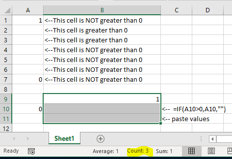

I finally figured out how the ghost cells were created.
If you use an IF formula to clear out zeros, using double quotes like this: =IF(A10>0,A10,"")
Then you copy and paste the VALUES from the results of that formula, you end up with the broken shared strings index like you said.

I guess I just have to be very careful in the future when using the ="" in any formulas. It does not return an truly empty cell and may have negative affects later if someone uses copy and paste values. ie =if(xx>0), or selecting the cells and looking at the count at the bottom footer. Strangely the =count(xx:xx) formula doesn't count them, it only counts numbers, not text or empty strings.

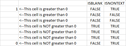

Huh, interesting; there are a couple of Excel tests that do show that those cells are different. Note that using "" essentially is an empty string, so a cell with "" ought to be different than a truly empty cell, as shown by testing the cell in Excel itself:

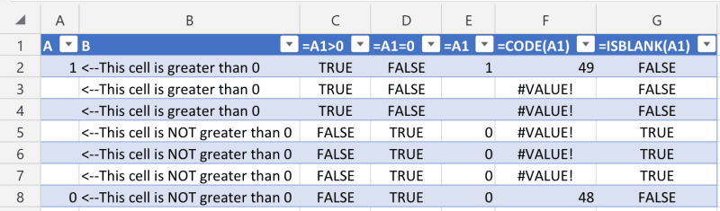

I put some expressions in the adjacent columns as indicated in row 1, FYI.

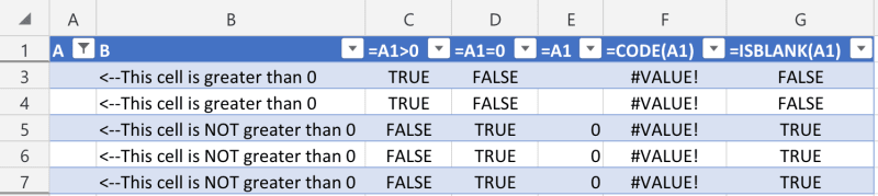

Notice that your rows 2&3 my rows 3&4, that if you need to identify empty cells then if you select (Blanks) in a filter then those 4 rows will be displayed, even though ISBLANK() indicates FALSE.
