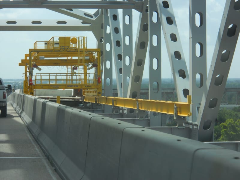

FYI - we built cranes that had to climb 4" in 37' x 1150 ft long (was a bridge over the Mississippi river)
extra HP required was minimal

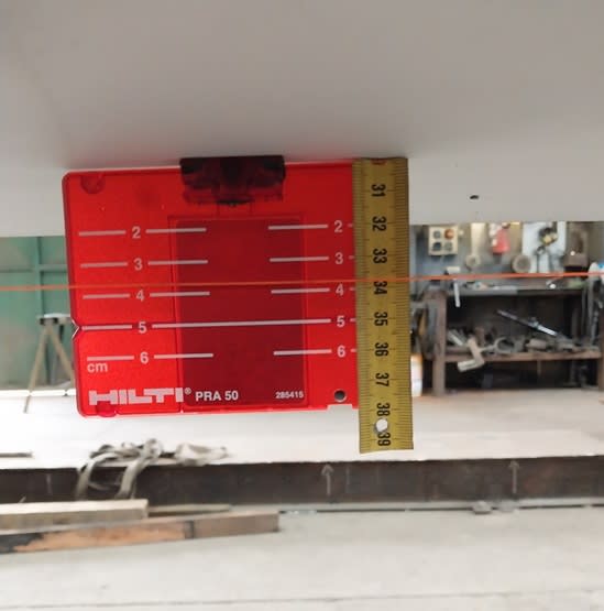

Thank you all for your replies. Camber is up. It was measured with a fishing line and a piece of measuring tape on the middle point. The girder was on the floor laying over supports on the ends, where carriages will be.

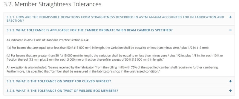

As LittleWheels asked about what fabrication tolerances standard we were using, I found the AISC has a Beam Cambering Tolerances standard. But following this criteria, we would be out for about 10mm.
