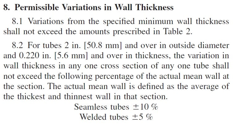

Reading the following it would appear that the +-10% tolerance only applies to diameters above 50.8 mm:

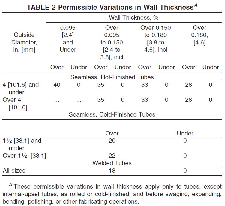

However, from this table, considering for example a typical OD 25.4 and thk 2.11 mm tube, no negative tolerance is allowed:

A179 says that it is for minimum wall tubing.
A450 is a general spec, it contains all of the options for applicable product specs.
And the product specs always override the general specs.
In software when you enter a specific material it should be pulling the data from the correct product spec.
Many product specs give both AW and MW tol ranges.
Because +/-10% is not exactly the same as +20/0, and some specs reflect this.

Under tolerance of wall thickness of tubes (as table 2) is 0 (ZERO), hence no affect the calculation.

My doubt arises from the fact that for the most common carbon steel tubes (e.g. SA179 and SA210) the undertolerance according to the respective specifications is 0, whereas for a tube in SA 789 the specification explicitly states a tolerance of +-10% (e.g. for diameters between 12.7 and 38.1 mm) from ASME II part A-2 Table 5 page 1328).
So surely in the latter case, if you order the AW tube, the negative tolerance of 10% should be considered in the calculation.
This is why I ask my question again, when ordering tubes in SA179 or SA210 AW, we are theoretically ordering a product that does not comply with ASME, right?
