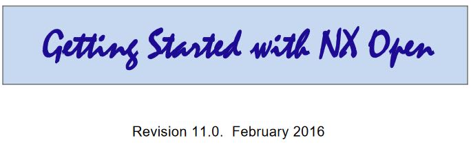

Hi Ehaviv,
I could not find that information in the guide, are you talking about this one :
I could not find any mention about visual studio profesionnal edition.
You can find it here (end of chapter 3, page 27):
However, this was written when the 'express' edition was a pared down version of the professional version. I think the new versions (community edition) includes the debugging features. I'm not 100% sure, but I think the community edition (free) would let you do the line by line execution and set break-points for debugging.

Thanks, I was not aware of the v12 of this guide. This make much sense now. I will give it a try with Community edition, the installer says it provides just-in-time debugging as well.
Regards,
Okay, I'm still force to start code from NX (Ctrtl + U) but at least JIT debugger allows me to stop code and use step by step instruction control.
