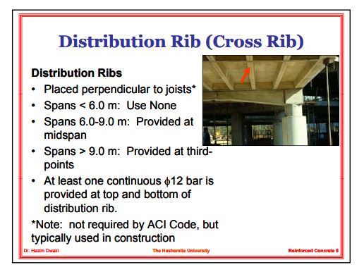

Hello,
I am currently investigating the removal of a bridging joist located at the mid span of the joist. The span is roughly 15 ft. and the joists 5" X 10" spaced 25" on center. Looking at current ACI design for one way joist systems I have not encountered any bridging requirement, and the examples I have reviewed are for longer spans and much deeper joists.
I have not worked much with pan joist systems and not sure how and if their design has evolved over the years.
Are these bridging joist critical members or more to assist with load distribution?

I have experience with Eurocode 2 and in order to give an idea i have copy and pasted clause 5.3.1(6) ;
(6) Ribbed or waffle slabs need not be treated as discrete elements for the purposes of analysis, provided that the flange or structural topping and transverse ribs have sufficient torsional stiffness. This may be assumed provided that:
- the rib spacing does not exceed 1500 mm
- the depth of the rib below the flange does not exceed 4 times its width.
- the depth of the flange is at least 1/10 of the clear distance between ribs or 50 mm, whichever is the greater.
- transverse ribs are provided at a clear spacing not exceeding 10 times the overall depth of the slab.
Apparently one transversal rib/ distribution rib would be necessary to comply with EC-2 in order not to treat as discrete elements..

Distribution ribs are not required by code (ACI) but are typically used in most all concrete joist construction for the intended purpose of unifying deflections from local point loads.
They are not required for strength/safety but help minimize cracking in the top slab due to differential joist deflections.
Taking one out, or cutting a large hole in it, shouldn't be a worry. I'd avoid taking multiple, and adjacent, ribs out to allow at least one distribution rib to connect to any one joist.
