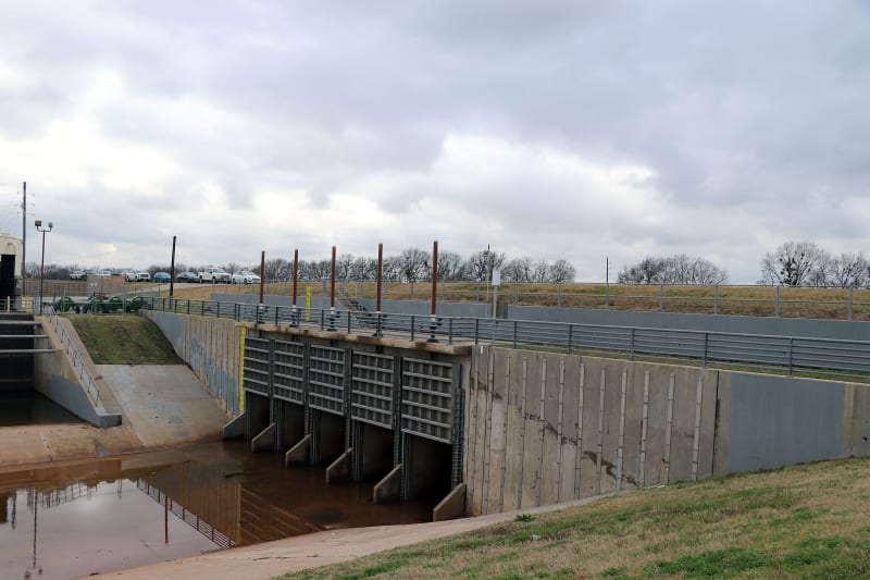

I call this the Frankenstein wall. It was broken back and raised with a deadman & stainless straps about 15 years ago. Then, about 10 years ago the levee was raised so the terraced upper wall was added.

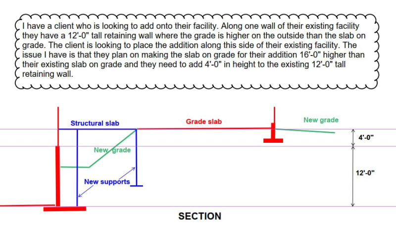

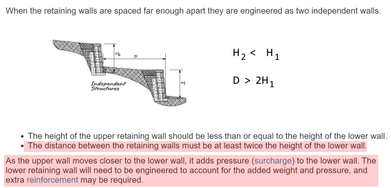

If distance between new wall and existing wall is less than 24 feet:
"There is no free lunch."
I propose a different solution. See cross section below.
