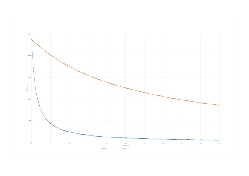

Thank you very much Scotff. Very interesting feedback. Based on all this information, however, I am starting to think that a 1A design should have better performance. I justify it below:
Say that we start from a 1200:5A CT design. From the comments, keeping the same core we could fit 5 times the number of turns, provided that we reduce the section by 1/5. That is, we have turned a 1200:5A CT into a 1200:1A CT keeping the core size.
The new transformer would have a secondary winding resistance 25 times larger than the original 5A design. On the other hand, since we keep the core size, the new transformer will be able to withstand secondary voltages 5 times larger than the original. Additionally we would have secondary currents five times lower for the same amount of primary current.
Applying all these assumptions to a real 1200:5A C400 sample whose magnetisation curve I happen to have:
- The saturation voltage of the original design is 445 V. Hence the new 1200:1A would have a saturation voltage of 2225V.
- The original CT has a Rsecondary = 0.45 Ohm. Hence the new transformer would have a secondary resistance of Rsecondary = 11.25 Ohm
Now, if I calculate the primary current that would drive the CTs into saturation (CT secondary voltage equals saturation voltage) considering different CT burdens, I get that the 1A sample is always able to withstand higher primary currents. That is, for the same core size the 1A has better performance.
In the curve:
- X axis: Zburden.
- Y axis: Primary Current.
Would you agree with this?
In my experience, when you factor in the increase in Rct (as you mentioned), the increase in the relay's burden between 5A and 1A rated relays, and the lead impedance between the relay and CT (most users use different size leads for 1A rated vs 5A rated CT), there is very little difference in actual primary current saturation point.
