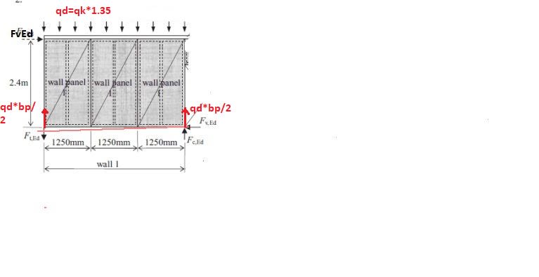

Can someone expalin the calculation shown with yellow?
- Take FBD of panel 1,
- Horizontal load at the top ( the left corner ) for the panel 1 will be Fvrd/2=FvEd,
- Apply a small uplift at the left corner to get max. conn. force between adjacent panels ,
- Then the max. conn. force at left corner would be F1v= FtEd - qd*bp/2
- Then calculate the shear at the first conn. ( 1250 mm from the right corner ).
Fv= F1v + 2qd*bp/3

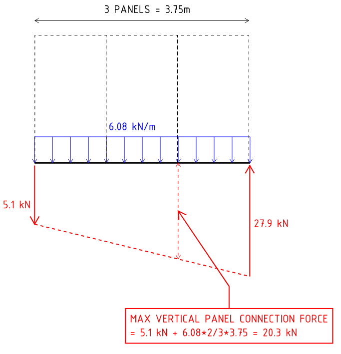

Yes but why is the uniform load been taking into consideration twice? 0,5*q_p*b_p+ 2/3*q_p*b_p
I mean the compression from the unfor mload 0,5*q_p*b_p is logic but i really dont understand where the 2/3*q_p*b_p comes from. Is it the weight from the walls? because that is not given :S
Draw the SFD. Max panel vertical connection force occurs at the panel 2 & 3 interface:
