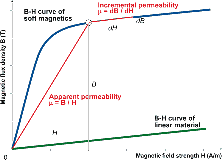

Yes, this is the reason why the current increases abruptly when the core is saturated. As permeability drops, you need a lot more current to increase a little of flux. See below (the same curve that represents B/H can represent also V/I - or more properly emf/I0 - with the proper axis scale adjustments):
Take into account that, even when saturated, the iron core does not behaves exactly as an air-core. Granted you may have the same incremental permeability but you are already working on a much higher B (with much more flux and energy also) and the apparent permeability will remain pretty high for any practical working point.
This is all very theoretical, hope it helps.

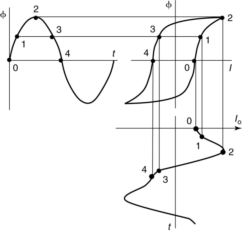

In AC, the curve posted above becomes a loop, called hysteresis loop, you can see that both flux and current follow each other with a certain "delay". Here the thing gets more complicated as the magnetizing current not only will change its rms value if the core is saturated but also its "shape".
