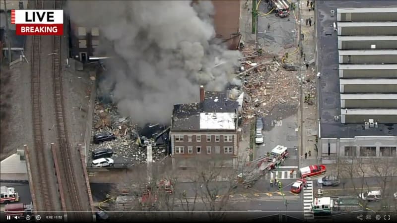

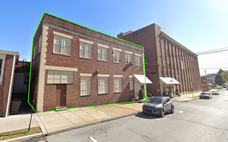

Explosion in Pennesylvania 2
This building appears to be gone.
17 S 2nd Ave West Reading, Pennsylvania
(Google Maps)
RM Palmer chocolate factory ABC News
It appears that there are deaths and serious injuries as a result of this incident:
Police: 2 Dead, 9 Missing In Penn Chocolate Factory Blast
An explosion at a chocolate factory in Pennsylvania Friday evening has killed two people and left several others missing as investigators begin to determine a cause.
