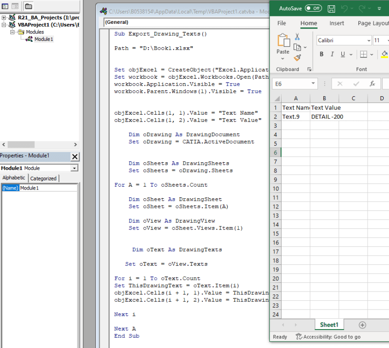

this is not really needed:
Code:
oView.Activate
problem with the loop :
Code:
For i = 2 To oText.Count
Set ThisDrawingText = oText.Item(i)
objExcel.Cells(i, 1).Value = ThisDrawingText.Name
objExcel.Cells(i, 2).Value = ThisDrawingText.Text
Next i
the first text this loop will find is oText.item(2)
you will miss few texts in your drawing....
maybe the following will work better:
Code:
For i = 1 To oText.Count
objExcel.Cells(i+1, 1).Value = ThisDrawingText.Name
objExcel.Cells(i+1, 2).Value = ThisDrawingText.Text
Next i
What is the problem / error you have ?

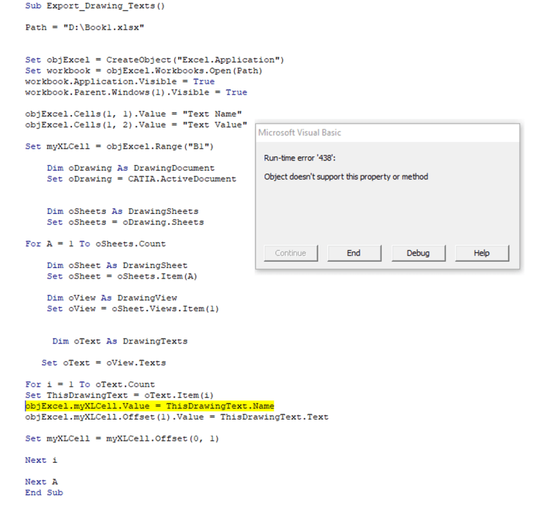

Hello Eric,
I am getting out please refer the image. thanks for your support
ah... ok i have the feeling the excel counter need to keep going, no matter which sheet, view and text...
replace
Code:
objExcel.Cells(1, 1).Value = "Text Name"
objExcel.Cells(1, 2).Value = "Text Value"
with
Code:
set myXLCell = objExcel.Range ("B1")
and in your loop replace
Code:
with
Code:
objExcel.myXLCell.Value = ThisDrawingText.Name
objExcel.myXLCell.Offset(1).Value = ThisDrawingText.Text
set myXLCell = myXLCell.Offset(0,1)
Eric N.

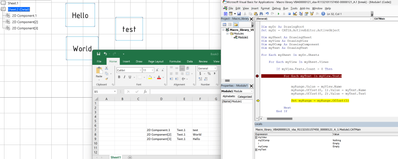

Hello Eric,
getting error while running the micro. pls refer image
sorry about that
replace
with
myXLCell.Offset(0,1).Value = ThisDrawingText.Text
set myXLCell = myXLCell.Offset(1)
Eric N.

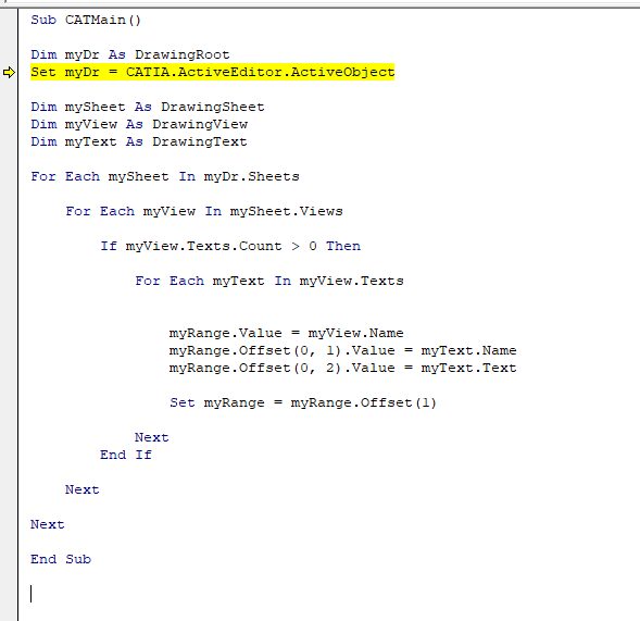

Eric N.
Good Morning Eric,
I am getting error while running to micro, Please can you validate my mistake,
I am using 3DEXPERIENCE I have the feeling you're not.
in 3DX I get the active drawing with
Code:
Set myDr = CATIA.ActiveEditor.ActiveObject
in CATIA V5 you do
Code:
Dim myDr As DrawingDocument
Set myDr = CATIA.ActiveDocument
Eric N.

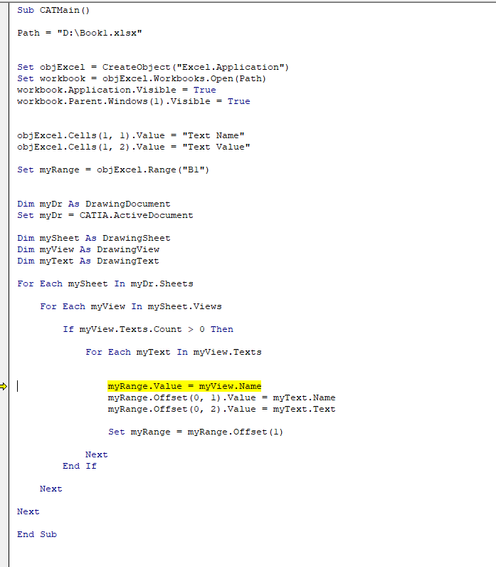

also do not forget to include the EXCEL definition section in your code...
Code:
Set objExcel = CreateObject("Excel.Application")
Set workbook = objExcel.Workbooks.Open(Path)
workbook.Application.Visible = True
workbook.Parent.Windows(1).Visible = True
set myRange= objExcel.Range ("B1")
Eric N.

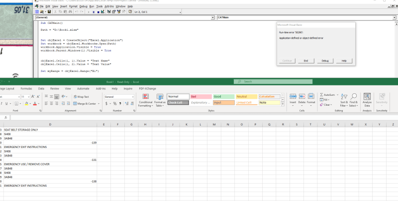

Hello Eric,
Thanks is working but, still i am missing some placard text and also look like micro stop working with some issue please check
what I am getting when i run the micro
and error
Thanks once again for your prompt support
well if you don't need the view name in your output.. just remove this line!
Code:
myRange.Value = myView.Name
Eric N.
maybe you could set myRange to A2 (instead of B1) so title and data will be aligned
Eric N.
Hello Eric,
you are the best, you made my date. Micro is working like a butter
thanks a looooooooooooot for your help
have a nice weekend
Regards
CODE IS AVAILABLE ABOVE... with 1 or 2 changes that are also detailed above
