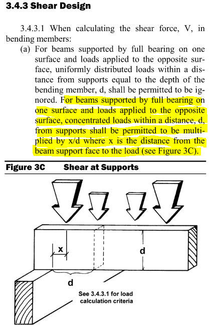

By the book, I think that we're not supposed to use the "d" thing for concentrated loads. So there's that...
Indeed. Not as helpful as one might hope.
Also, I'm not sure if everyone does this, but I usually include this concentrated load in my bending check as well, even though it's less than "d" from bearing. And for large loads such as that 47kN, it can make or break the design. But I'd love to have someone convince me that the stresses don't work like that and it can be ignored.
2018 NDS:
