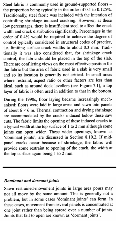

What I have heard and used is that there is not any linear benefit to slab on grade reinforcement between 0.1% and 0.5 or 0.6%. Anything in that range is equally (in)effective at translating concrete shrinkage strains into steel strains and therefore controlling shrinkage cracking. So 24-36*thickness should still be used.
Once you exceed 0.5 or 0.6% steel, then longer spacings could be obtained using a procedure like the subgrade drag equation (although in some circles that has fallen out of favor).

The 0.5-0.6% number is intended to make the steel stronger than the slab, or at least not much weaker. Otherwise, a single crack can form and open wide due to yielding of the steel. 0.1% steel has about 20% of the concrete's strength in tension, so does very little to cause a second crack (and third etc) to form and distribute the shrinkage relief. Other forms of restraint (like whatever caused the first crack) are more likely to distribute the cracking if so little reo is used in a large slab.
The discussion below is from an older version of a UK design guide (Concrete Society Technical Report 34).
