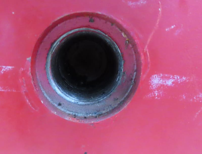

Hi there,
We have to lift a heavy plate, it has existing threaded holes to screw in eye bolts.
The thread is an M64, but it is counterbored with a diameter of 80mm and the counterbored surface is not flat.
The contact area of the M64 eyebolt is 120mm.
So the surfaces touching are from 80 to 120mm. Here a sketch showing it. One image is worth 1000 words...
Is the contact area enough to use the maximum load capacity of the eye bolt?
We will also use it on the side of the load and pull at 90º
I was thinking to manufacture a washer to fill the gap, but since it is very irregular (and not flat) and I am afraid it will stick out and then only touch it and not the area of the big diameter.
Maybe a washer made of rubber? It could stick out a bit, then when screwing in the eyebolt it will deform and maybe help a bit increasing the area?
Are these counterbored holes normal to use with eyebolts?

I wouldn't use about a "fill" washer. Check the contact area and stress using the available surface. If less than yield you are o.k.
drodrig,
The face at the bottom of your pocket probably is drilled. Of course it is not flat. Who cares?
I assume your eye[‑]bolt has a rated lifting capacity. If it doesn't, get yourself a new eye[‑]bolt.
When you install the eye[‑]bolt, there will be a compressive stress on the [⌀]120mm/[⌀]80mm[ ]face, and a tensile stress on the screw that must not exceed the rated capacity of the eye[‑]bolt. As you lift, the compressive stress on the face will be reduced, and the stress on the screw will remain approximately constant. When your lift exceeds your installation clamping force, and all sorts of interesting and undesirable things will start to happen. If your pocket is deep enough, it will reduce your thread engagement to something less than what is required to achieve the eye[‑]bolt's rated strength. If your thread engagement is marginal, a washer will make it more marginal.

Since the contact diameter of the eye bolt is larger than the c-bore, the presence of the c-bore is meaningless if you have adequate thread length contact. No need to try to fill it in. I am much more concerned about the force at 90º. Make SURE the eye-bolt manufacturer guarantees to you that it is rated for that lateral load.
Hi drodrig
Instead of the 80 diameter counter bore, why don’t you put a spot face onto the surface and then drill and tap your hole through the spot face, that way you solve the problem of the area under the contact is no longer.
Instead of worrying about the place where the eye bolt doesn't touch, maybe think about the place where it does touch.
Depending on the material of the "heavy plate", and how tightly the eye bolt will be tightened, crushing of the annulus is possible.

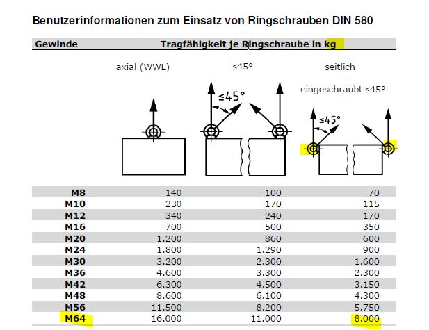

Lifting eye bolt ratings are stated for direct, in-line forces. They de-rate for other directions.

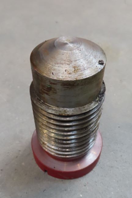

I am thinking about making some big washers.
The pitch of the eyebolts is 6mm, i would do two types: 1.5mm and 0.75, so we can rotate them a quarter or an eighth
Here a picture if it helps
difficult to see it without a reference for scale

We can't change the design. I don't know after tighten how the ring position will be. Washers with 1/4 and 1/8 of the pitch seem a good idea
The table with the forces comes from the DIN 580

The only problem spreading the load by using washers is you also reduce the amount of engaged thread and that’s not a good idea.
