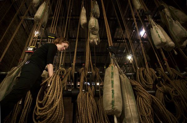

Um, hasn't that been done with ropes and sand bags for hundreds of years?
True, but alas the deliverable is completely against using any sandbags or manpower. Everything needs to be automated. [dazed]
