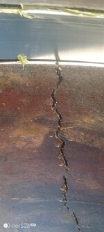

Valve Data:
Borsig Ball Valve 36" ANSI 600 RJ
Type: Trunnion mounted/Top Entry
Process Fluid: Gas
Operating Pressure: 490 psi
Max. Allowable Working Pressure: 830 psi
Max. Allowable Working Temperature: 110 Degrees Celsius
Ball & Seat Rings Material: F316
Year Built: 1977
Test Pressure: 2175 psi
This valve was initially hydro tested in 2020 after general overhauling following long period of operation to keep it as spare (Body test Pressure kept at 1500 psi due to fabricated blind flanges leaking, while ball was tested at 1585 psi from both sides) Test Passed.
The same Valve was tested again in July, 2024 for confirmation at 1250 psi and 940 psi for the body and ball, respectively. Test Passed.
It was retested again due to the third party witness request in February 2025 at 1250 psi Shell, 940 psi Seat (High Pressure Closure) and 80 psi Seat (Low-pressure Closure). Test Passed.
After all these tests and before installation of this valve to replace an existing valve at an export line, but within the concession of another company, this company request to test the valve again at their premises in the presence of our representatives and the witness of their engineers.
The body test was conducted with no leakages at 1900 psi.
The ball first side test was also successful at 1600 psi.

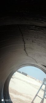

Shockingly, and during the final stages of the gradual increase of the test pressure of the ball second side (at 1200 psi), a loud voice was heard and the pressure started to fall very slowly.
After releasing the pressure and subjecting the valve to visual inspection, the ball was horribly cracked (photo attached).
Personally, I can say that this is the first time I encounter such failure and I would like your support in analyzing such incident and investigate its probable causes.
