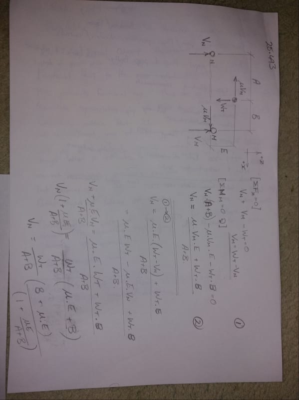

That formula is a plain static balance of forces equation. Rearranged to solve for the nosewheel vertical reaction force.
I suggest you draw the plane as a free-body diagram and solve for moments about the main wheel axis.

Solve for moments at the nose wheel contact with the runway, noting that the force on the main gear is from both the nominal weight on wheels but also is relieved by the overturning moment from slowing the plane that shifts some of that force onto the nose gear. Essentially solve the horizontal acceleration in terms of the normal force on the main gear.
Once one determines the vertical force available then from friction that is fed back to determine the horizontal acceleration.
Knowing the horizontal acceleration, one takes moments around the main gear - the moment the normal force the nose wheel reacts to. Keep track that each part of the expressions have the correct units.

Here you go. A bit clumsy.
I'm sure there's a more efficient way to the same solution, but it works.
Shown nearly every step for clarity
The f is tacked on after the fact.
Note for simplicity V_M is the total main gear reaction in my freebody. (Whereas faa is 2V_M)

I see where I went wrong:
1. I assumed from Figure 6 that there is a friction force also applied at the NLG-which I see only now applies if the NLG has brakes. Do you know perhaps if the A330-300 has brakes at the NLG?
2. I worked through the problem with the dynamic factor included - not applying it at the end.
A thousand thank-yous. You are a truly helpful engineer.
No problems, glad it helped.
I'd say with reasonable certainty the a330 does not have Nlg brakes, they're quite an uncommon design feature. Might be available as an option, but unlikely.
