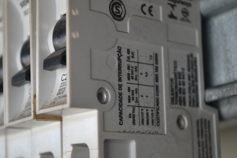

What can you experts say this fault was cuased by? please see attched picture
Lets see here, what does not look right.
Overpacked conduit, sharp edges on cable, maybe some over heating caused by dense packed wires, or maybe over current.
The insulation seems a little rough, so they maybe a little old style.
Slag on the base of the conduit, could be arcing, or leftover from welding.
Seems to be clean around the conduit, was it swept, or natural blown?
Open weep holes, likely nothing, but not positive.
Gee looks like age and abuse.
I've seen sharp conduit edges cut through many a conductor before. When they are first installed, the cable sheath comes out of the conduit, as it should, but over time the cable shield gets pulled down, and your conductors end up being exposed to the sharp edges on the conduit.
That's one possibility...
edit: changes cable 'shield' to cable 'sheath'
First thing that stands out to me is over filled conduit. If the load is high enough on each conductor they will over heat bundled like that. Understanding conduit fill and de-rating are essential.
Agree with mbrooke, looks like long-term thermal effects on the insulation. W-a-y too many conductors in that conduit.
Agree with comments about the general state of the installation too - something was going to go wrong, it was just a case of which fault happened first.
@cranky: this was the first view so no one cleaned the place.
We had the same conclusion, overpacked conduit, so it was just a metter of time after construction for the failure to happen and the fire that destroyed many small market stores. We found other cables still intact but damaged by sharp edges of other conduits, so it was just a matter of time...
On reconstruction we will change many design details and will supervise the construction as the codes state. Thanks for your observations!

There was overheating for a while, but once the insulation broke there was a short circuit and the slag shows that. You are right cranky, those holes should had never been left open, that won´t happen again
The code does not require sealing of weep holes. Punch outs, yes. But none the less if the environment is such things are getting inside you might want to consider a different NEMA enclosure. If someone can get conduit fill wrong good chance they got the enclosure wrong as well.

@itsmoked: yes, probably the EMTs heated up so high and there was a flamable material close by that started the fire.
@waross we are using NFPA 70 too, and the derating factor is considered now in the new design that it was not done before. Thank you
