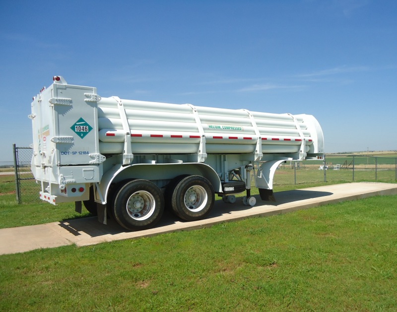

That's a 26" sphere with a 10" hole in the middle, 8" thick. By the time you welded two halves together...come to think of it, what with the forging and all, might be cheaper to build the whole thing up from weld metal like a 3-D printer.
Theoretically, spherical vessels might be cheaper, in reality, that depends. So you wind up with stuff like this:
