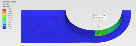

Hi to all you FEA guys! Hoping you can shine some defining light onto an FEA aspect where I need to gain some more clarity.
The subject where I would appreciate your input is the FE analysis of pin loaded lug and clevis joints.
I've challenged myself to the task of creating a hand analysis template that calculates aspects such as the max principal and shear (tresca) stresses, and also the bearing contact loads for a lug. I would like to compare the output of my hand calculations to the results obtained from an FE analysis. This is a personal home project only, and as such I have no test data to compare to. My aim is to gain insight into the contact modelling of such joints, and to know that the approach I'm taking is relatively realistic.
Where I think I need more clarity is in the settings applied to the contact surfaces, in particular the pressure overclosure slope parameter 'k' given as N/mm^3 (surface contact stiffness). I'm using open source software to create the 3D model (FreeCAD) and to conduct the FE analysis (PrePoMax, version 2.2.0). The pictures shown are of the 3D model and the 1/4 FEM (grey lug, green clevis).
The FE models I've created consist of an Aluminum Alloy Lug and Clevis, with Steel or Titanium Pins. I'm also modelling different sized pins (same lug length). The pin diameter to lug width ratios are 0.25 (as shown), 0.50 and 0.75. PrePoMax uses the Calculix solver, and the 'k' values are based on the modulus factored by a value between 5 and 50. For the combination of materials, I'm using the analysis approach given in Roark, for two dissimilar materials in contact, to obtain a base-line modulus value. Some say to use a 'Hard' setting, although the 'k' value of which I don't know. Others say that a hard setting is too high and a lower value based on E should be used. In addition, some say that the 'k' value should be a function of E and thickness. I've tried a few variations. The max principal stress doen't seem to be too sensitive to the 'k' value, but the Tresca stress does vary somewhat.
Any input you can give would be much appreciated.
There were some larger discussions about this parameter on the CalculiX forum. One good way to determine it is to use:
Code:
0.5*(E_stiff+E_less_stiff)/L_char
where L_char is the characteristic length (the typical length of the element edge at the contact boundary). This is usually adjusted in the case of convergence issues but it may affect the results significantly as well. Thus, it's good to have an analytical solution for reference.

For the 0.75 dW lug, this is the contact bearing pressure I obtained. As you can see, it's relatively constant and locally peaks.
You can see the output for the bearing pressure calculated by the hand analysis method. It's taken to be uniform over the lug thickness.
It's just a confident 'k' factor would be good.

I suggest you use much wider lugs (longer pins) to start with so you can ignore the funky end effects caused by pin bending in your FEA. Your FEA confirms the (in my initial opinion hard to believe) uniform pressure over much of the bearing, but does not agree with the spike at 78 degrees.

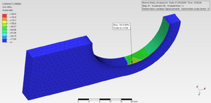

The FE model is 1/4 of the lug, so you're seeing 1/2 the lug thickness. This is the most current FE model version (done today with a revised 'k'). The position of the peak may be off, but the bearing stress level is quite close to the hand calc. The bearing pressure distribution for this dW ratio is a bit harder to profile, as the rate in change of bearing pressure is quite high over a relatively small angular range. My 12 x 12 stiffness matrix is based on 8 degree point loading steps. For more refinement, I'd need to reduce the angular step, giving a larger n x n stiffness matrix.

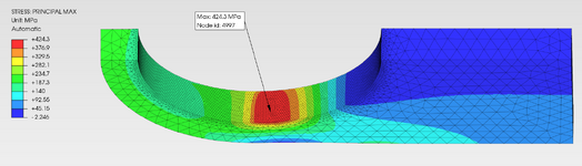

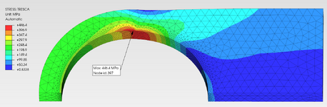

These are the Pmax and Tresca Shear FE results from the current version. With PrePoMax, the displayed Tresca Shear needs to be divided by 2. Below the two FE plots is the Pmax and the Shear from the hand analysis.
Hand analysis results for Pmax and shear stresses.

I have never seen a tested lug fail in bearing at the side of the hole. So a predicted peak bearing stress there makes no sense.
The purpose of my investigation is to try and predict the Pmax and to obtain the kt. I’m not trying to predict any failure mode, to do so would involve plasticity. A part of the approach was to first come up with the lug loading, just like a typical beam analysis. My investigation also involves 0.25 and 0.50 dW lug ratios, where the lug wall thickness is more significant. With a dW of 0.75, are we beginning to see a form of strap loading behaviour?
My interest now is to compare my hand calc results to an FE analysis. The aspect of the FE modelling causing some issues is the deriving of a confident ‘k’ factor.
Any help in calculating ‘k’ values involving 2 materials and lug geometry would be much appreciated.

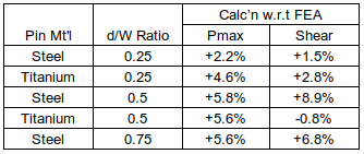

Just as an indication, these are the current hand calc to FEA results (use of older FEA results).
The shear is seen to be more sensitive to the used k factor. At the end of the day though, all are affected by the k value.
