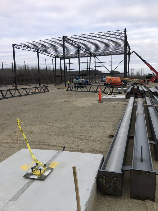

I ended up making a trip to the field yesterday to assess the existing conditions. When I arrived the columns were back to being plumb again. When I dug a bit deeper, the site superintendent said columns were not braced at all in the orthogonal direction they were leaning.
This was the column line before plumbing again.

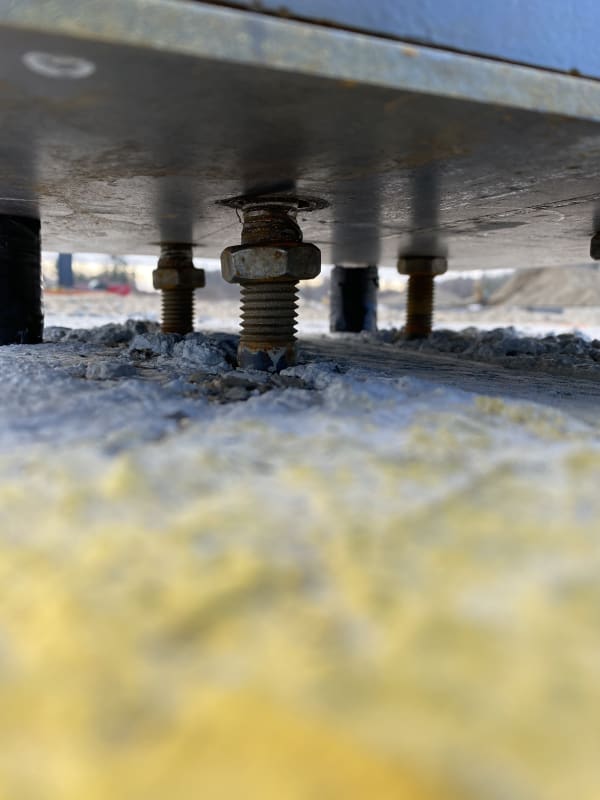

This was the best picture that I could get of the condition under the bolt.
We are planning on doing a pull test on the bolts..... maybe to 100% of the design load to make sure there are not any issues (not sure if this is a good idea, but I am 95% sure that everything is OK, but I'm not willing to die on the 5%). One column doesn't technically need any bolts as there is only downward loading on the column in that location. We are planning to test one bolt there... and then test one additional bolt in each column if things go OK.
Man they're really lucky that whole thing didn't topple over...
Looks like there was plenty of thread. Did they explain why the use of half height leveling nuts?
Agreed. Poor practice that somebody really needs to be informed in no uncertain way that it is unsuitable.
Though I would question whether the engineered design is partly the cause. If this is a design that relies on the roof diaphragm then you really need some temporary bracing in the mean time. Maybe that is the norm in this locality, but temporary bracing is often as troublesome to install and remove as some permanent cross bracing.
Likewise engineers love to pass off temporary bracing requirements to the GC, but often the GC is not suitably informed to provide appropriate temporary bracing. Again this is my experience in my locality, but may or may not be applicable elsewhere.
Generally, the stability of the building is up to the contractor/steel erector to figure out during construction. This isn't an overly complex building so no real fancy erection engineering is necessary. Yes, the building utilized a roof deck diaphragm to distribute the lateral loads to a concentric bracing system. The steel erector will typically use steel cables to brace the building. In this instance, this wasn't done on this line..... but was done on others were there was no issue.
I mean, don't most buildings use a roof diaphragm?
Ahhhh. Certainly not a common practice here.
Yes, I told them had it toppled over they would be replacing all the steel... which they have been waiting arrive for months.
Why did they use 1/2 nuts.... they actually use jam nuts for this application. We typically specify 3/4" of grout under leveling plates. If they had used full sized nuts then they might not have had enough adjustment in some instances (the footing in question looks slightly low so it looks like they could have used full sized nuts here).
I told the GC to use a different method for shoring up the column after proper elevation has been achieved. Now he keeps asking for approval for different methods he is proposing. Unfortunately I am not offering any solutions for him at this point for the reason XR250 outlined above.
We are going to have the bolts tested to 110% of the demand to see if they are compromised. I don't know if this is appropriate or not, but it is the only way I can think of that we can prove no other damage has occurred to the bolts during the stripping process.
FYI, this picture was taken 800 feet from the entrance to the jobsite.
SteelPE, I vaguely recall that I think I also used to spec 3/4" or 1" of grout below baseplates. Then, somewhere along the way I came across the advice (I can't recall when or from whom) to specify a minimum of 2" of grout below baseplates. I think this is part of the reason why.
