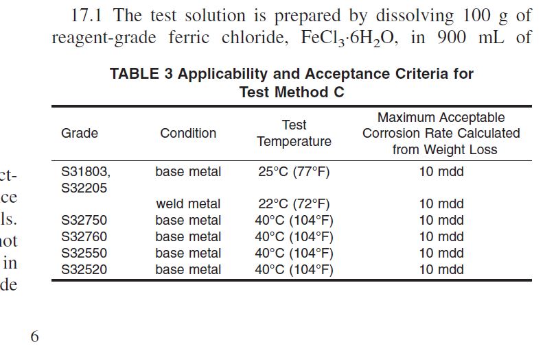

Yes I have two 1/4"x2"x2" samples ready to send off to the lab for testing to ASTM A 923 Method C. Question is, at what temp do I wish the samples to be subjected to?
I've attached the temp chart.
Robert
I presume that the 2205 was precured with A923 testing.
I would use 30C as a starting point.

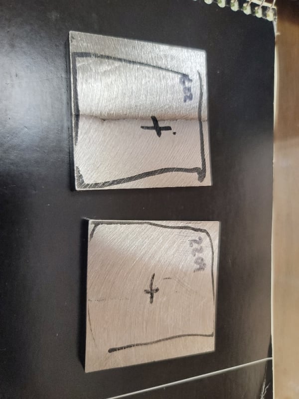

How were the samples prepared? I presume that they are full thickness with both the face and edges of the welds exposed.
It looks like you have ground the weld caps off, I hope that you didn't take much metal.
I also hope that these were not acid cleaned after grinding.

I would start at 30C, and then run 35C, 40C, and so on until I get pitting.
Then go back to a safe temp (maybe 3-5C below pitting) and run a few duplicates to show that you have it well defined.
The corrosion test can become part of your PQR and welder qualification.
I presume that the 2205 was precured with A923 testing. Ordered standard as ASTM G 28-02 (Reapproved 2015) Methods A & B.
I would use 30C as a starting point. Unfortunately we do not have the luxury of numerous testing and are limited to testing the two samples at either the higher or lower temperature. (But I will run it up the flagpole)

How were the samples prepared? I presume that they are full thickness with both the face and edges of the welds exposed. Correct
It looks like you have ground the weld caps off, I hope that you didn't take much metal. Ground only to base metal and will be prepared by lab.
I also hope that these were not acid cleaned after grinding.No acid cleaned, sending as is to be prepared by lab.
You may need to run many more samples to get a good idea. I agree
I would start at 30C, and then run 35C, 40C, and so on until I get pitting. If possible will do so.
The corrosion test can become part of your PQR and welder qualification. On previous 2205 to 2205 with ER2209 w/ TriMix it was required by Customer and was successful.

You could cut those samples into thinner strips, you won't need much weld to tell you if it works.
We used to test sample about postage stamp size, plenty of material.
The tip on small sample size will be used in the future when qualifying procedures.
