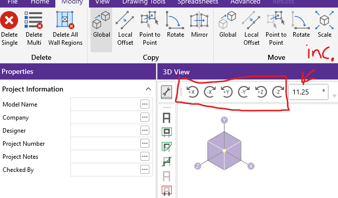

* Previous versions of RISA allowed you to rotate a model by repeated clicking. With the new version, you have to grab the axis diagram and use your mouse to rotate the model.

- I still have the axis rotate buttons in the tool bar, and it's still 8 clicks to rotate 90 degrees.

@DaveAtkins,
I came to say the same thing as WinelandV said. You can rotate by holding shift and pushing in your middle mouse wheel button.
Thanks, I will look for that.
DaveAtkins
Should be here:
