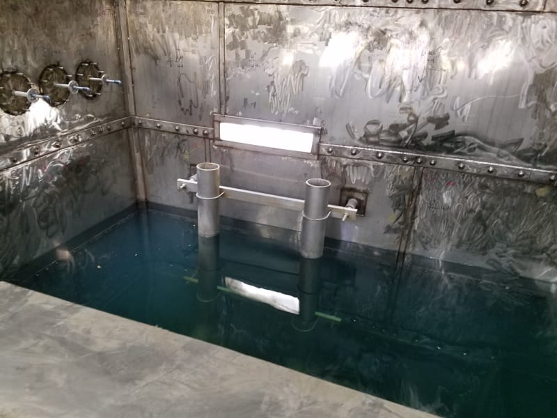

At my facility, we are currently lining 5 sumps (35' deep x 13.75' wide x 47' length) with stainless steel liner. Essentially, these are field fabricated 316 SS tanks built inside sumps. The sheet is 0.125 and most of it is 10' w x 4' high in size. At the horizontal seems, there are 0.25 inch thick straps with anchor bolts every 6 inches. The vertical seems have 2" wide straps with no anchors. The sheet is laid against the sump walls and floors which are 18" thick steel reinforced concrete. We also have 14 weep holes per sump to monitor for lining failure (2 on the floor, 12 on the walls). I have included an iso cut for reference.
Each sump has ~ 1 mile of weld. The QA/QC included visual, dye pen, and vac boxing. Sump 1 has failed three hydro tests and sump 2 has failed twice. All failures resulted from water flowing from the weep holes underneath the floor. Sump 1 is currently on the fourth go around of QA/QC inspection. The contractor has tried putting air behind the sheet (both with and without water in the sumps) to see if bubbles appeared or air leakage was detected, but they didn't. They never built any pressure behind the sheet, so we suspect all the air was making its way to the top and escaping through an unsealed area. They hired a 3rd party CWI to reinspect, which resulted in nothing found. They are going to try ultrasonic testing today to see if they can detect leakage locations. X-ray is out of the question because of the concrete behind the sheet.
Anyone have experience with a situation like this and/or have thoughts on other methods to detect leaks?

We have considered dye, but to selectively cover 5400 linear feet, then put water on it and hope it shows at one of the weep holes is low probability of success. We have also consider helium with a sniffer but suspect it will be the same as the air test (where the helium just blows out at the top). Another thought was florescent dye, but we would need to inject behind the sheets at pressure. The sheeting is designed that anymore that 1 foot of head behind it can cause the sheets to fail, so we have been very cautious with putting anything behind the sheets.

Ultrasonic testing did not detect any anomalies. Several repairs were made based on visual, dye pen, and vac box inspections. Hydro again last night and it failed again.

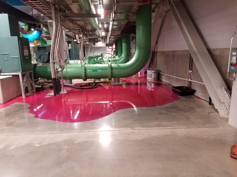

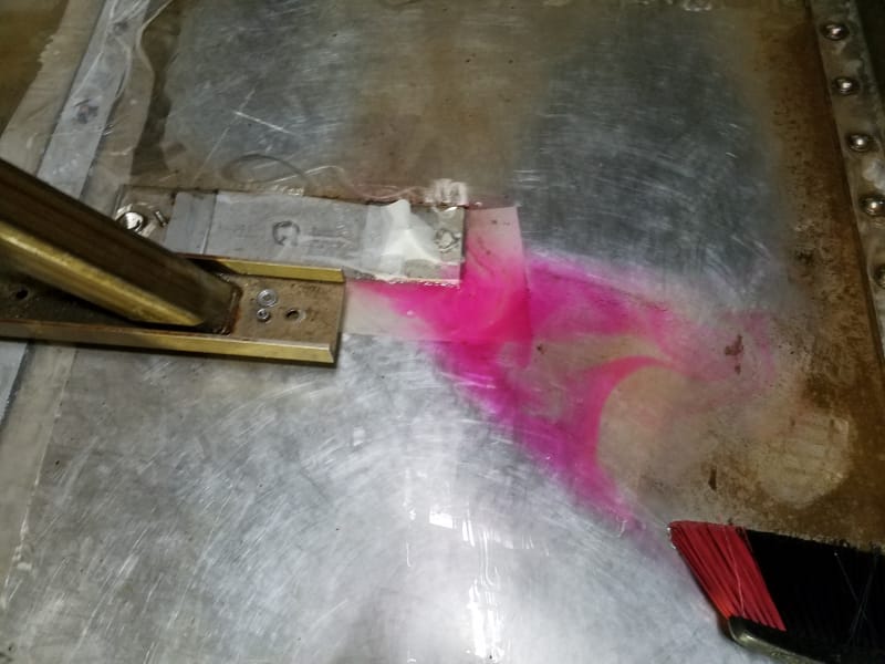

Did a reverse hydro/dye test and found one large flaw. Repaired it and rehydroed the sump to find leakage rate unchanged. The contractor also managed to spill about 100 gallons of dyed water all over the building.
