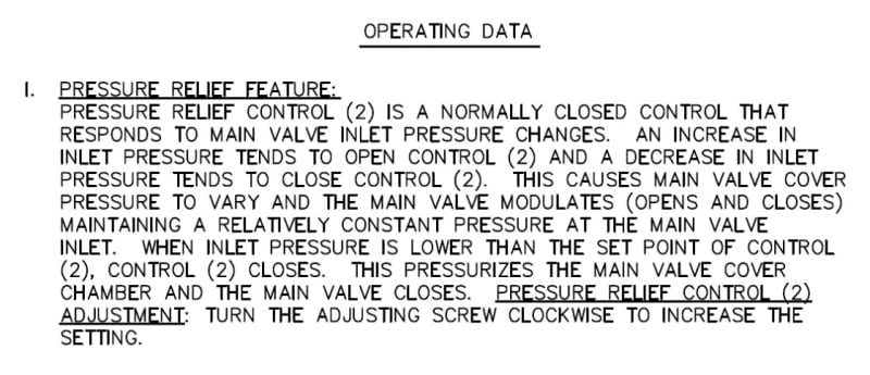

I am trying to understand the operation of a regulating pressure relief valve on a fire pump.
The way I understand is that the valve starts to open when the pump discharge pressure rises above a set-pressure defined by the spring. When the demand changes on the system, i.e. when more deluge monitors open, the system pressure will likely drop below the pressure relief set-point at which point the valve will be closed and the system pressure will drop depending on the required flow through the system and the characteristics of the pump curve.
However I have found a statement from a valve manufacturer that seems to contradict my understanding; "it maintains constant system pressure at the pump discharge within very close limits as demands change." Found here.
How can it be possible to maintain constant discharge pressure when demand changes?

That is the wrong valve for your application. The valve that you are referencing is only "regulating" pressure when it is relieving pressure.
It will only maintain the pressure when the system is flowing at or above the maximum pressure because it is relieving enough flow to maintain the pressure. At low pressures, it will not maintain pressure. See the instructions:

In which case I think my original question still remains unanswered in that a pressure relieving valve does not maintain constant system pressure as far as I can tell.
The question was answered above by the paragraph from the instructions for the relief valve that you identified. The answer is that once the valve is relieving, the valve will maintain relatively constant pressure in the system. This may be acceptable on a simple fire system, but may not be acceptable on a complex fire system with widely varying flows and pump curves. Suggest you review the fire system with Cla-Val or Singer.
A relief valve or pressure relief valve (PRV) is a type of safety valve used to control or limit the pressure in a system; pressure might otherwise build up and create a process upset, instrument or equipment failure, or fire. ... As the fluid is diverted, the pressure inside the system will stop rising.
The relief valve that you have identified will only control the system pressure once the system pressure is above the relieving pressure of the relief valve. If the pressure is less than the relieving pressure, the valve will close and there is no control of the pressure.
Ok I'll try again, this time with numbers.
what I believe this system is in essence a pressure regulating system ( forget the word relief in this instance.)
Replace your actual numbers with the ones below, but follow through the logic
Your pump is sized for a duty of 100 m3/hr at 7 bar.
At 80m3hr the pump delivers 8 bar
At 120 m3/hr it delivers 6 bar
Your valve is sized to lift at 7.2 bar and has a capacity of 100 m3/hr.
Pump starts, no flow into fire water system, Pressure builds to 7.2 bar, flow through valve 100m3/hr, flow through system 0
Flow into fire system is 50 m3hr, pump delivers more flow, pressure falls, valve starts to close. system balances out and now pressure is still 7,2 bar, but only 50m3.hr goes through valve, 50 into system
Flow into system is 100m3/hr, pressure is 7 bar, valve is fully closed
Does that make sense now - pressure stays at 7 to 7.2 bar.
Key is how accurate you can make the set point and operation of the valve and how steep your pump curve is at the duty point (the steeper the better)
