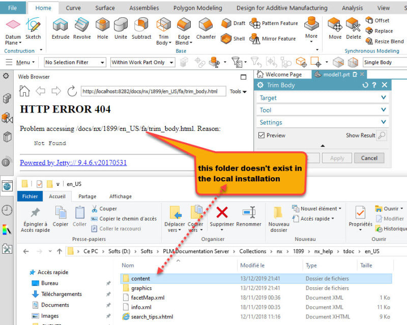

With an open menu like Trim Body, it's now possible to open the first assistance tab in ressource bar
But it doesn't work when documentation is installed in local
A folder "fa" is missing
Does anybody encountered the same issue ?
