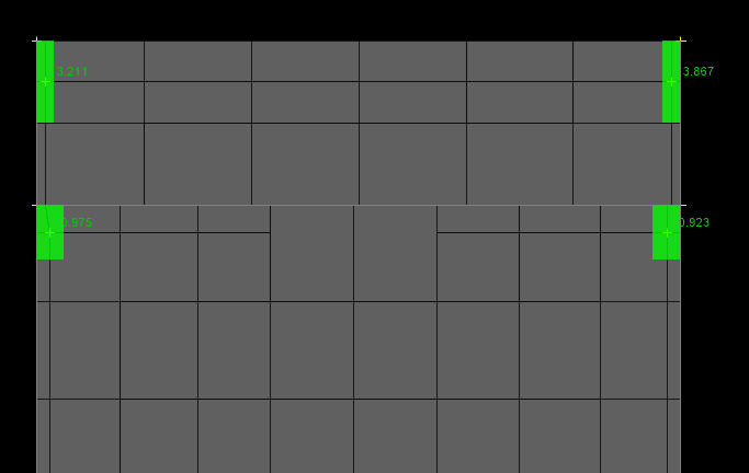

I have two 8x36 "wallumns" next to two 12x24 columns. The FEM results show a massive overstress in punching shear due to the minor axis moment.
Can I pin these columns to remove the moment? Normally, I don't do this because it's very unconservative for punching shear. But my engineering gut is telling me that these wallumns are almost like shear walls, where I do release the moment. So if it works for shear walls, it should work for this. Visually and intuitively, they're taking quite small loads. But I don't want it to actually punch through in real life, especially when the overstress is this high.
That being said, I'd also like to check this by hand. I think my go-to, the direct design method, is out the window because it doesn't meet the conditions. Can someone guide me in the right direction for doing a secondary check?
The other option is to just remove these columns, but I don't like it. It's a 6' cantilever with heavy SDL (concrete pavers).

What does the auto-mesh look like? I was having some very odd results in a model lately, and it turned out to be a mesh problem.

@Brad805 The mesh seems to be pretty reasonable.
Edit: I tried to use a general triangular mesh and got similar results, so it's not the mesh. But thanks for the tip. I'll keep that in mind if something weird comes up in the future.

Is that your mesh? What size elements are we talking? Normally for concrete I don't let the elements get much bigger than 1' x 1' because the moments from out-of-plane forces will be underestimated. This could be a stress concentration....and with such large elements....very concentrated.
@WARose It was maximum 4'x4'. I changed it to 1'x1' (my computer didn't love this) but all my punching shear results went down a bit. Thanks for the tip! I resolved this already thanks to the other comments, but this is a great thing to remember.

Your mesh doesn’t appear that the interior slab is connected to the exterior? The exterior has nodes of it’s elements along the boundary of the interior slab mesh.

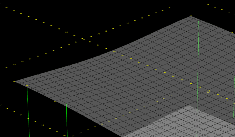

@Brad805 Yeah, even with a smaller mesh, it looks like there is a small amount of "tearing" in the 3D displacement. Will investigate further.

@Celt83 It's connected but there are little tears in the displacement. I'll contact support about how to fix this. There's a general triangular mesh option where it doesn't tear, but I just don't like it (I'm not used to it, it's a new thing). I might have to go with that option. And yeah, I'll try the 2D frame program. I wish I knew how to do this by hand; I could've just checked the one way shear, but I'm not sure how to check it with a partially fixed support.

A general commment on your FEM model - you're getting that tearing along the line b/w your "squat-er" wallumns and your narrow wallums b/c your plate nodes aren't connecting. Maybe your program has a super fancy element, but generally you'd want to get the corner nodes of all adjacent plate elements to be shared. Depending on how you want to handle it, you could end up with some triangle transition elements, some trapezoidal transition elements, or a very small mesh size across the model if you're determined to only have rectangular elements (all corners at 90 degrees).
What software is this? If what winelandwv said is true ("tearing" due to incorrect mesh, i.e., nodes of plate elements ending up "in the air" although the intention is to model a continuous plate), it doesn't exactly inspire confidence in the results.

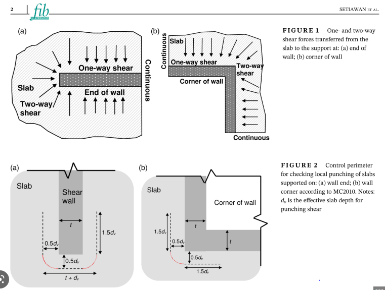

I agree, and a lot of folks do that successfully. Moreover, with a support of these proportions at an edge condition, I don't feel that two way punching shear provisions are all that relevant anyhow. And ACI's latest reflects this sentiment in that your allowable punching stress will likely wind up being, effectively, one way shear just as tomfh mentioned.
When it comes to this kind of stuff, I feel that Eurocode has been leading the way as per the diagram below. In accordance with that, I'd be inclined to check one way shear over an L-shaped section proportioned like Eurocode does it.
My approach would be this:
1) Accept that this will be rough stuff unlikely to be fully captured accurately by any production FEM model.
2) Throw in that pin as you said.
3) Provide copious "detailing" top steel coming off of the wall perpendicularly.
4) Have well anchored bottom steel running into the wall perpendicularly.
5) Run some healthy top steel and integrity steel over the wall and near it, parallel to the wall.
With all of that, you should have both reasonable crack control and a safe design.
