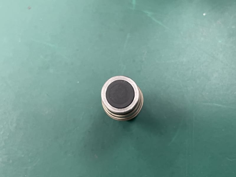

I got problem that FKM seal will stick to anodized aluminum after 9 days` chamber test(-30degree 5%humidity for 72h,40degree 90% for 72h, 60degree 5% humidity for 72h).
This lead to failure of movement for armature.
Any guys know the reason of this stick issue and how I can avoid this problem?

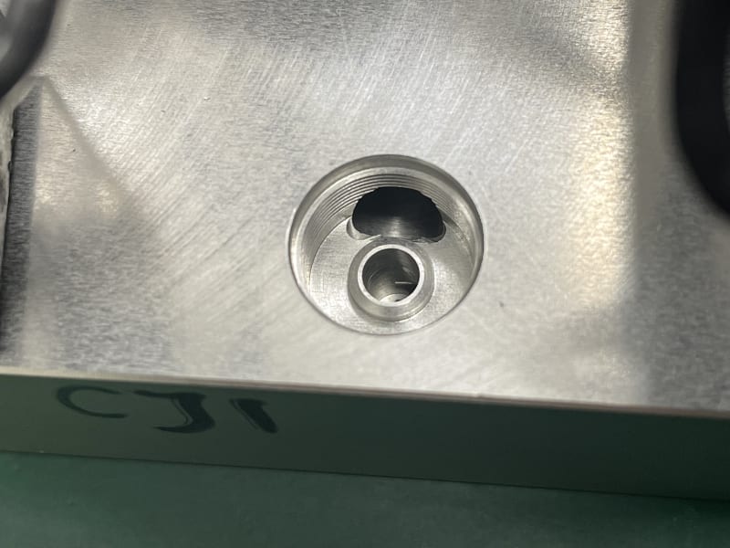

Which picture shows the surface that the material is sticking to? Labeling the items might help.
It's possible the anodize wasn't properly sealed following the anodize process but it may also be that the material was incompletely polymerized and is simply gluing itself to the surface.
Does this form a seal in a liquid handling system? If so what is the liquid?

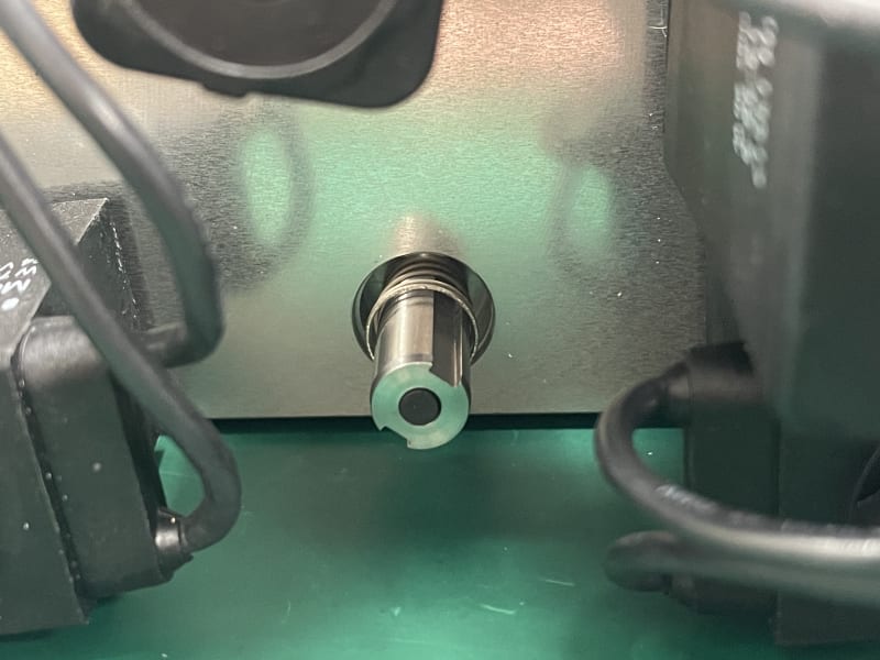

1st pic showed rubber stick to AL. You can see armature did not fall off under gravity.
Pic 3 showed appearance of sealing rubber after contacted with AL under pressure of solenoid spring.
This solenoid is normal closed, FKM seal is to seal this hole. There is only air in base. Power on the solenoid will let armature move and gate will open, air can flow then.
Your opinion that "anodize wasn't properly sealed following the anodize process" may cause stick issue, maybe no any surface treatment on AL will be better for this case.
