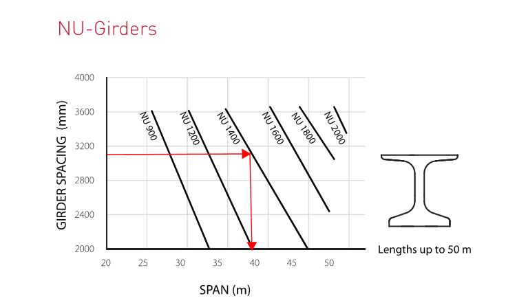

Why no girders - local NU girder manufacturer seems to supply span larger than 25 m. This bridge is only 20.3 m

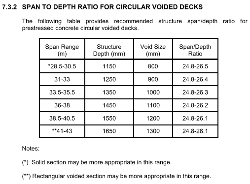

Why no post tensioned voided slab - local jurisdiction suggest solid section for small spans.

Or put void formers in the slab if you do want to simplify formwork and not use to cast in place beams to reduce self weight.
