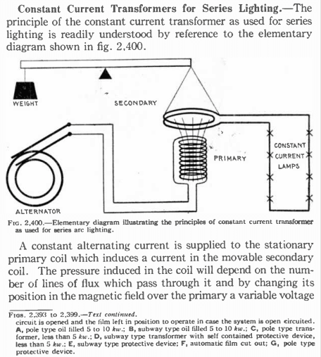

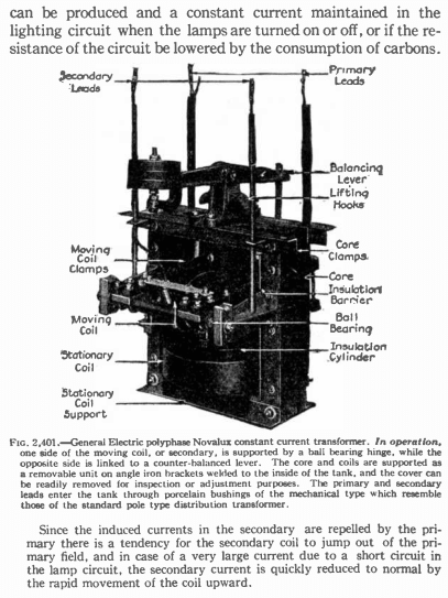

Here is a really ancient example. Constant voltage input, and approximately constant current output, by moving one of the transformer coils. Once used for street lighting.
Audel Electric Encyclopedia 1935 p1693 and p1694.
Note this is a GE example from long ago.
