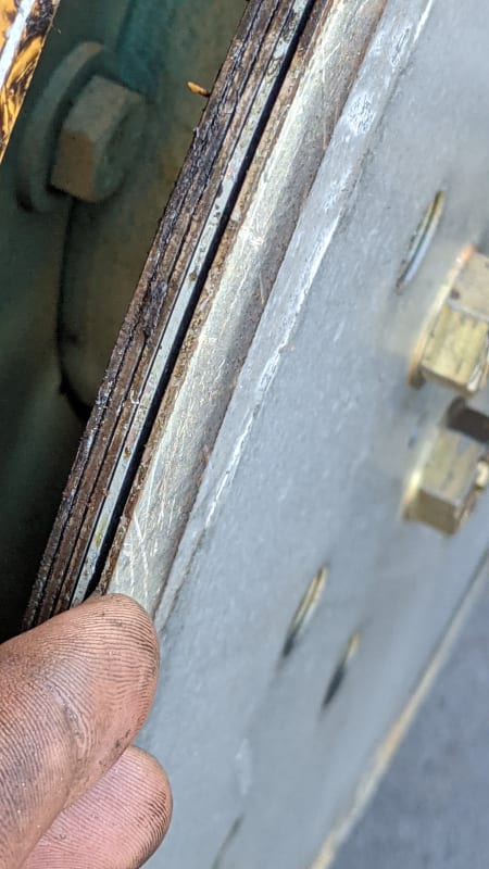

I just happened to be removing generators from one of my boats today. Here is the stacked disk flex plate. It's about 1/4 thick with 5 disks.
Wow, very interesting. A laminated construction was not on my radar at all.

Question how do those 5 plates attach to the one towards the outside with the threaded holes? Nuts on the back side? Or vise versa.
