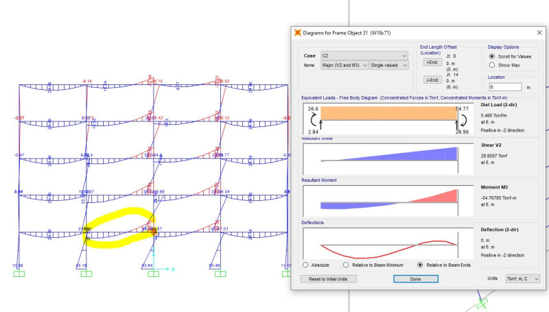

I've got a question of an academic exercise.
I'm analysing a beam of a 2d Frame. The beam length is 6 meters (600 cm).
The section of the beam is a W16x57.
Lb=600 cm.
According to my calculations.
Lb>LP (464 cm)
And Lb > Lr (557 cm)
So for Flexural Design I should Use (F2-3).
The problem. Is when I use SAP2000 to design the beam. Sap uses MP (F2-1) ignoring the LTB.
I'll appreaciate your help
