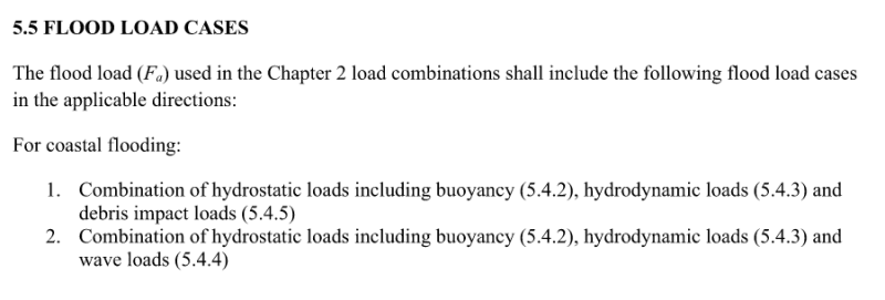

I'm designing a solid concrete flood wall. I've looked through FEMA P-55 but still have questions on how to combine different flood load cases.
For one case, I think I need to combine hydrostatic + hydrodynamic + impact.
But how should I combine the loads when there is breaking wave? The breaking wave equation has baked-in hydrostatic pressure based on still water height rather than the (DFE - grade) height. Should I do hydrostatic + breaking wave + impact or just breaking wave + impact?
I'm attaching a screenshot from FEMA P-55.

Your screenshot and also ASCE 7 supp 2 both don't require debris impact combined with breaking wave load.

Supplement 2 to ASCE7-22 says this:
I disagree that wave loads should be combined with hydrostatic and hydrodynamic loads, as wave loads themselves are a combination of hydrostatic and dynamic loads (a different vertical distribution than hydrodynamic loads). It's double counting if we do that.
FEMA P-55 says this:
Again, based on ASCE 7 and FEMA P-55, my understanding is to combine:
1. Hydrostatic + Hydrodynamic + impact
2. Wave pressure + impact
This is also my understanding and I agree that the hydrostatic load component is baked into the breaking wave equations in the code. For breaking wave load combinations, you would not need to separately compute the hydrostatic pressure as you would with other the other loading scenarios.
