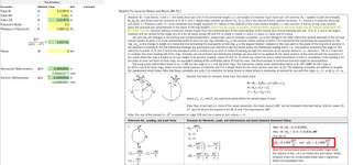

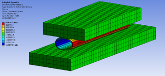

I'm looking for ways in which I can calculate the displacement (vertical and horizontal) of a tube being crushed between two flat plates. I have managed to set up a non-linear material profile and simulate this problem using ANSYS however would like some sort of hand calculation to ensure I am in the correct ballpark. Length of the tube is 0.1 m and a force of 5 kN is applied to the top plate (tube dims and properties as illustrated in the excel spreadsheet image).
I have stumbled across Roark's Formula for Stress and Strain using Table 9.2 Formulas for circular rings however my calculated values are significantly less than my FEA - not sure where I'm going wrong here - Am I missing something to be so far out?

Thanks for the reply! however even when applying relatively low forces on the simulation (to the extent where the deformation is mainly elastic) the values still do not align. Am I missing something?
Is it because the force peaks at the start then reduces, a bit like a rod with Euler buckling
Roark is a linear analysis assuming small displacements. your FEM is large displacements, geometric and maybe material nonlinearity.

A few thoughts:
Your FEA shows a diameter change of 3.4mm horizontally (I'm assuming that's the X direction), which is large in relation to the wall thickness of 1mm, so I wouldn't expect it to line up with Roark's anyways (as others have already stated). Also, having the displacement be asymmetrical just strikes me as a bit odd.
I quickly duplicated your hand calcs and got 0.15 mm Dh and -0.17 mm Dv, so you might want to double check your calcs (I might be wrong since it was quick). For reference, my calcs had R = 7.438mm. I believe the long ring assumption you highlighted would require converting your load W to load per unit axial length, so 50 Kn/m.
Also, is that an acceptably fine mesh for this type of analysis? I've never done any FEA with material non-linearities or used Explicit Dynamics, but if this was a static analysis, I'd be looking at increasing the mesh density through the pipe wall thickness before I trusted the results.

Fairly a newbie to non-linear FEA analysis myself, However thanks for pointing out the force per unit length- missed that one. that certainly brings me a bit closer.
I think the asymmetrical displacements were due to my poor meshing skills - I have since updated the model and it deforms a lot more how I would expect.
Comparing this to my calculation in line with Roark's, I'm approximately out by double - I imagine this can be explained by Roark's being a linear model of calculation hence not considering the plastic range.
The KISS rule is 3 or 4 mesh elements across a wall thickness. Your mesh is horribly coarse, unless that's just ANSYS displays it.
EDIT: I'm usually running garbage Solidworks Simulation, but I'm not sure that Explicit Dynamic is the best simulation type for this scenario. ANSYS describes it as more suited for transient events, temporally bounded. I have no idea what that would be adding to the calculations, but in this case I would be running a simple static load deflection study first. If that didn't make sense, then I would re-run it as non-linear/larger displacement study. Even ANSYS says if you aren't specifically interested in time-dependent effects... don't run an explicit dynamic study. Use an implicit dynamic study. https://www.ansys.com/blog/what-is-explicit-dynamics. Unless you want to crush the pipe entirely, I would see this as a basic "barely non-linear" study. Particularly if you're comparing to hand calcs, which are fully elastic.

I did initially try a static loading scenario however didn't give me what I was looking for. The implicit dynamics route sounds good to me - I'll give that a try thanks.
The factor of 2 is just because Roark's is calculating change in diameter, while your Ansys result is effectively change in radius (if you just look at the max displacement). But they also differ by an additional factor of about 100. Your Ansys plot shows a diameter change of 2.5mm (range of your deformation scale), while your hand calc shows 0.027mm. I would reduce the loading in Ansys until your deflections are smaller (say a diameter change of under 0.25mm) and then rerun your hand calc with that loading to check agreement (also double check your hand calc is done correctly). That should reduce the effects of large displacements and/or plasticity (hopefully). Also, you should refine the mesh until you get more elements through the thickness of the pipe. I'd concur with Orange_kun that 3-4 elements is probably a decent target, but since this sounds like a learning experience for you anyways, keep pushing the mesh finer and see when the change in results slows down with each mesh refinement.
