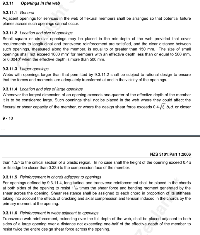

For a building refurbishment project ,it is required to provide 6”x 6” opening along RC beams of sectional size 9”x18”.
The existing building (03 storied) is about 25 years old and for the concrete structure, Grade 25 concrete has been used. According to the available structural drawings, the beams and the slab is being adequately reinforced. The span of the longest beams are is 21’-0” & 13’-9”
The previous use of the building is for a hotel and it will be refurbished for the same functional use.
I proposed the following methodology for the process of making 6”x6” openings in RC beams
1. After fixing proper steel props & other safety measures, 1/4 L of from the supporting column (Point of contraflexure region),a 6”x 6” opening on the beam shall be done using manual tools
2. The opening to be made with an extra 20 mm and a square sleeve fabricated by welding 8mm thick steel plates to be inserted & fixed in the opening by using high strength concrete grout.
( this arrangement will compensate for the loss of shear strength at the RC beam opening -but I don’t have a calculation to prove this)
I need your comments & opinions please

A few thoughts from me…
I am assuming the cross-section is 9” wide x 18” deep and the opening is going to be on the centreline of the beam depth?
Are you sure that your proposed cut location will not hit any existing steel, particularly stirrups?
I think, for a 6” hole on an 18” beam depth centreline, assuming no steel cut, you will likely have more of a shear issue than a moment issue. So I would be aiming for a point of zero shear, not zero moment.
I do not believe that your proposed solution will do anything for the shear capacity of the beam. So hopefully the shear capacity of the beam will be sufficient at the location of the hole.
Note that, in our code at least, we end up having to ~double the design shear force above and around penetrations, so you want to check your code provisions to make sure what you do is actually compliant with those clauses too if present
I would make sure your proposed hole stays the hell way from any yielding regions, if this is a seismic zone
Your hole will also generate additional bending forces due to the shear force acting at a lever arm equal to your hole width, so make sure you have sufficient moment capacity at the hole location to handle these extra bending forces (on top of the major bending component)
6”x6” openings for 18” deep beam makes 33% of the depth so, can be considered as small opening. If possible, you may shift the location to around L/ 2 where shear is minimum and shift the location just under the slab .
Wow your code is a lot more opening friendly than ours... we are limited to 1000mm2 for a 'small opening' for a beam of these dimensions
6"x6" is more like 23,000mm2, so not even close to being considered a small opening

Don't think of it that way... As they note, you try to put the opening in the area of least shear. The opening is small dimension and the resulting moment is not great... a couple of 15M bars under it and you're likely OK (you still check to see if it's OK).
It may not be doable. A 6"x6" clear opening must be 8"x8" to allow for the steel plates and drypack grout. Any stirrups existing within the width of opening will be cut. In effect, there will be no stirrups in the width of opening, which means that a 9"x6" 'beam' of Grade 25 concrete must be adequate to resist the shear. Do we know the magnitude of shear at L/4?

I can't see the benefit of the steel plates. If you can cut the hole neat, forget about the steel box. Don't make the hole at L/4, make it at centre span.
Practically speaking - and having chipped a lot of concrete over my lifetime - it is tough to concrete chip a small 6"x6" square hole through a 9" thick element, even with access to both sides.
I would concrete core a 6" hole.
...and nibble away the edges, carefully. Do they have a mortising bit for concrete? Maybe it's a round duct/pipe? [ponder]
Drilling an 8" diameter hole would be easier than the proposed scheme and would do less damage to the strength of the beam.

Coring a hole would definitely be the best way to go. But the size of the core would likely depend on the clearance for the drilling machine. I would be dubious about trying an 8" core. The vertical face of the beam below the slab is only about 13", and you don't want to get too close to the bottom bars.
