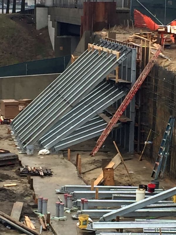

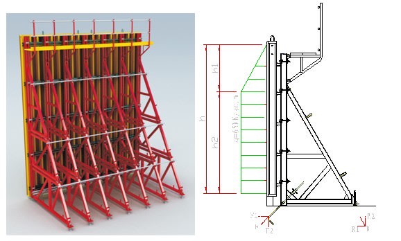

I'm designing a foundation for foundation for one-side-formwork. My problem is that after drawing the free-body-diagram, I am finding that I need a ridiculous sized footing in order to prevent the single side form from sliding.
Based on a 11' tall one-side-formwork, the formwork designer's reactions gave me a net horizontal applied force of 42kip per frame spaced at 4' apart on average. To resist that sliding force I extended the base-building footing to all the way below the far leg of the A-frame (R3y in diagram), so I can get all the downward forces possible x 0.35 for sliding, and got only 9kip of resistance. I then added 3'6" of passive earth pressure, and still only got another 9kip of resisting force. The code need a safety factor of 2, and I'm at 0.5. Am I missing something here?

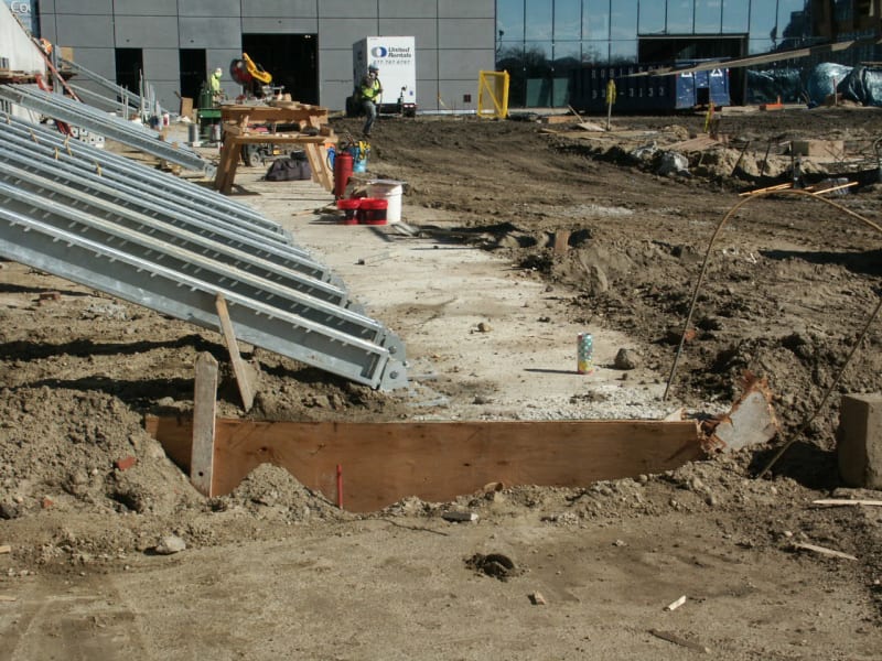

Another option is a forming system like this which designed for blind pours.
Another option is to install tiebacks into the soil (assuming its an earth retaining structure) behind. The tiebacks could have threaded rods that bolt through the forms to capture whalers.
Similar to what pvchabot is stating, get the formwork designer to verify/check the 42k/4' frame horizontal force.

Although 42 kips per frame is too conservative , i assume the design load provided by formwork supplier.. You do not need passive thrust to resist horizontal load 42 kips.
The horizontal load is resisted by R1x and the OT moment is resisted by the couple R1y and P3y... R2 y will develop as vertical reaction prior to concreting and after concrete get hardened..
If we assume fresh concrete depth 11 ft , the width of the bracket from R1 to P3 is 5 ft and assume the horizontal fresh concrete load is 42 kips, and neglect the wt of bracket ;
- R1x will be 42 kips,
- R1y = P3y = 42*11/(3*5)=31 kips.
The diagonal anchor at R1 SHALL resist to 42 kips V, 31 kips H. loading ..

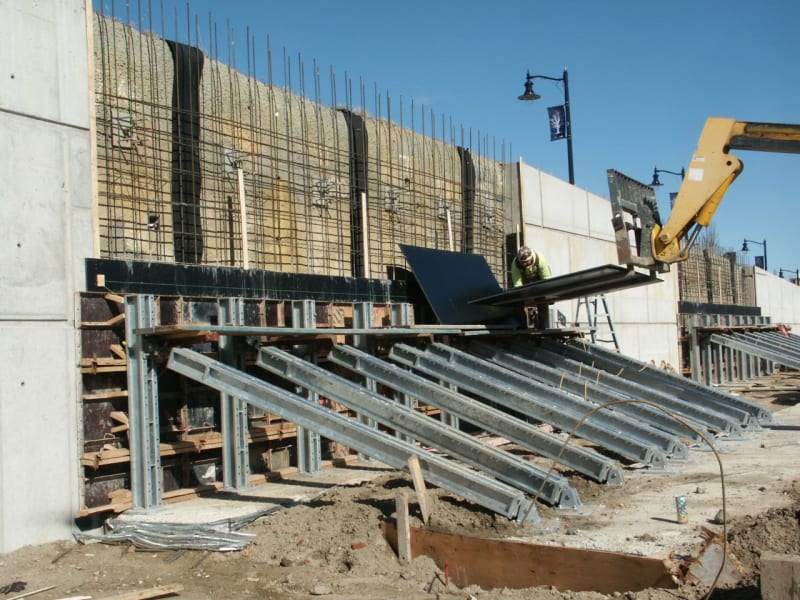

The following picture ( found at web ) explains the one side formwork concept
Sorry I forgot to clarify, all the forces in red are given by formwork supplier, which is based on a pour rate that limits maximum pressure to 1250psf.
R1x = R1y = 42kip
R2y = 29kip
R3y = 13kip
I think where I made it confusing is that the “R” forces are actually applied forces that I need to resist. I have yet to figure out how R1x can be counteracted as explained in my original post.

HTURKAK: I think the OP understand that the reactions from the forming system are locally reacted by the concrete footing (diagonal cast-in anchors etc), but OP is concerned with the global concrete footing (as a mass) in resisting this temporary (albeit very short-term) action.

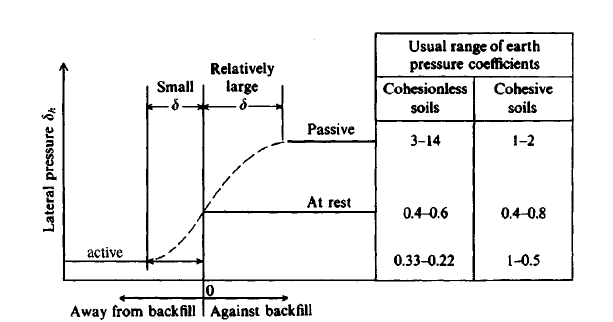

The following excerpt ( Illustration of active and passive pressures with usual range of values for cohesionless and cohesive soil.) from Foundation Analysis and Design ( by Joseph E. Bowles )

I have seen concrete counterweights ('deadman') used in some one-sided formwork situations, but they do not look like an elegant solution.
@HTURKAK: may I ask where you got took the graph in your last post from? That's interesting and I've not seen it before.

That chart exists in the Canadian Foundation Engineering Manual I believe.

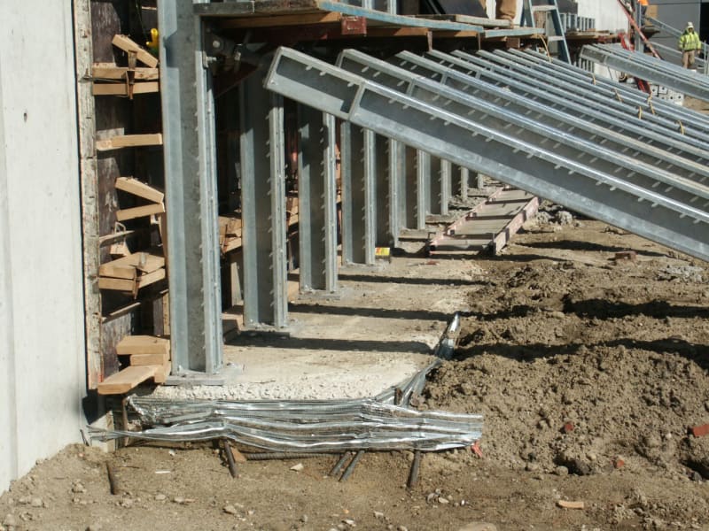

Yao1989, no, you are not missing anything. These one-sided wall forms do require a big, deep footing/block to resist the lateral pressure - unless you can use a smaller footing/block with some type of tieback anchor.
Thanks everyone for the feedback! Very useful info.

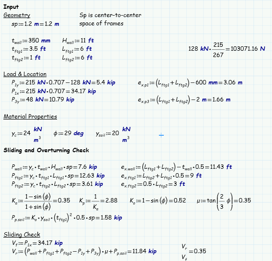

So I ended up asking to reduce pour rate to 4'/hr, and the reaction load has then reduced, but still 34kips or horizontal load to resist.
Seeing how much deflection before using passive pressure, I changed to use Ko at rest instead for soil pressure.
in below I have combined R1y & R2y into a single P1. long story short, even with reduced pour rate I still get nowhere close the sliding resistance. I'm pretty sure I have the correct free-body-diagram, so I guess one-side-formwork just need really robust foundations.
For my project I ended up asking the secant pile engineer if we can attach some D2L welded rebar to their steel secant pile to help resisting the horizontal sliding force. This makes most sense to me as now I have a situation that is almost like a tied formwork, except I only have a single tie at the base.
