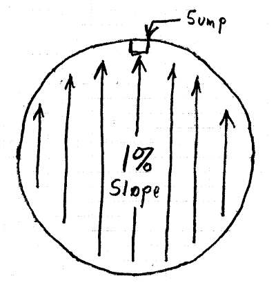

What is the best way to create gradient on the floor as I need a liquid to drain towards specific location?
This needs to be addressed before deciding on the rebar pattern. For example, if the drain in at the center a radial rebar pattern will likely be best.
If the drain is at the edge, there are a more options.
Also, the slope of the floor; is it minimal (say 1%) to shed liquid, or several percent to allow solids to be collected at a center drain using a rotating "rake"?

A small sump would be installed at the edge and gradient of about 1% is suitable.
I am waiting for the geotechnical report but hope to have a decent layer of chalk at low depth and a uniform strata.
Good, that make everything much easier. For one of our cooling tower basins (80+ meter diameter) I had the design team slope the entire floor, see the sketch. (Slope is to help plant operations wash down & remove sediment during outages when the basin is drained.) The floor slopes in one direction so that it remains flat & the rebar profile does not change, but not level. At first, the design team though this was a "joke"... it was not, alternate proposed schemes were more difficult (and expensive) to build watertight. The sloped flat bottom concept works so well, that 10 years later we did two more basin floors the same way. Suggest considering a similar concept for this project:
A varying height reinforced concrete perimeter wall will be needed to keep the tank/anchor bolts level.

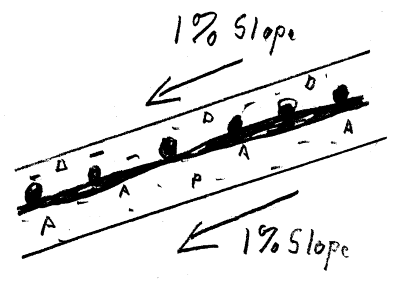

I know that we can't pour it in one go so I will provide continuous reinforcement through construction joints.
If I understand properly the slab will be on one end about 200mm+ 0.01*25m = 45cm thick whereas on the end with a sump 200mm. The reinforcement ration will drop sginificantly on the thick side but I guess this is alright?

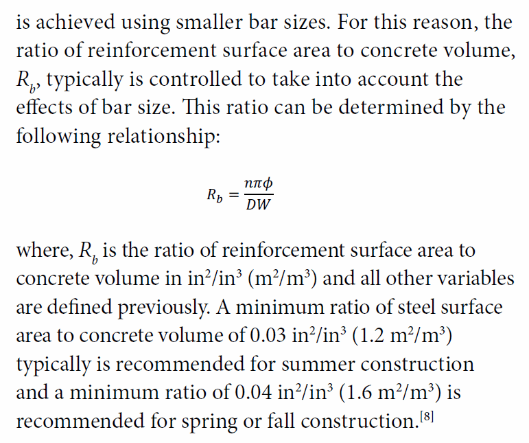

Where does this values of 1.2-1.6 m2/m3 come from? Would you be able to give me some reference to it, please?
Let's say my 12mm mesh @100mm c/c yields 12*pi = 0.038m2/1m of bar. I will consider that 1m3 of concrete occupies 5m2 of slab with 200mm thickness. For this I get the ratio of 0.038*10*5*2 = 3.8m2/m3 o which is way more then recommended. Unless the range 1.2-1.6m2/m3 is only for one way? How can I take it down keeping reinforcement ratio at about 0.5-0.6%?
No. Slab thickness is constant. Top of subgrade slopes 1%. Bottom of slab slopes 1%. Top of slab slopes 1%.

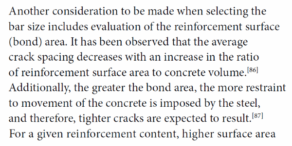

Too small and too close together. I get a a surface:volume ratio of over 18 m[sup]2[/sup]/m[sup]3[/sup] for 12mm @ 100 mm.
See my 18 Jan 2019 post about "small", "closely spaced" rebar.
"Continuous Reinforced Concrete Pavement Manual", pages 36 and 37

Thanks. I had a read and a 16mm bars at 180mm c/c seem reasonable.
