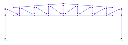

Hi everyone,
I am currently modeling a warehouse with a roof truss structure in SAP2000. I released torsion and moment, but when I analyzed the model, a warning about an unstable structure appeared. How can I fix this issue?
I hope someone would help me as I am completely stumped by this issue. Thank you so much.
Too many releases.
If all member ends are released at a node, then what’s holding it all together?
The column releases would be the primary problem. Otherwise it seems similar to a common old school pin truss model. In reality, your top chord rarely has this many pins. It is also common to have some small gaps at the web intesections to keep the fabrication simple.
