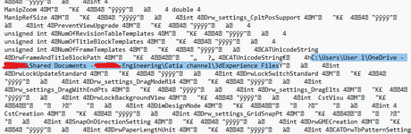

Hmm, I was just trying something that seemed to reference using an API to extract the catsetting file. However, when I hover over the little logo next to the Page Setup directory references a CATSettings folder and navigate to that folder, it seems to just contain an empty .txt file called 'Dummy_file' This might explain why when the last hotfix was pushed out, it didn;t save the Page setup Directory, even though we copied out our CATSettings file. It seemed like this particular setting wasn't saved in the CATSettings for some reason.....but then it has to be somewhere becuase it stays in there between closing and opening each session. Any ideas where this setting is probably stored please?
Oh - I found it. I've got the binary file that stores the Page Setup Directory path, and i just changed it to double check this was the correct one. Now I need to work out how on earth I make sense of it and extract this path from the file using a CATScript! (company name is redacted from the filepath!)
I'll keep working on it, but the rate I usually figure these things out, any help will be appreciated! Thankyou!

I ended managing to get it to work. It finds the CATSettings File, reads it looking for the string "DrwFrameAndTitleBlockPath" which I know is the name of the setting and comes just before the path I want to extract, then looks for the first instance of C: after this, then collects everything after "C:" until the first instance of character "Ÿ" which seems to mark the end of each CATSettings value.
It works really well, although I'm self-taught on coding purely for this specific task of writing our Frame/Titleblock script, so if there's anything in there that seems ridiculous or inefficient I'm all ears towards improving my stuff!

Great job, thanks for sharing.
Couple of suggestions:
1. Offset from a setting name to it's value is constant, so you can write it down in your code (this way you'll be able to get any path, not just on C: drive)
2. CATIA strings are null-terminated, so you better search for character with Asc(pos)=0 condition
