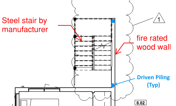

Hi everyone,
So we have free standing wood wall adjacent to steel stair for fire separation requirement. (IMO, it would be better to just leave steel stair alone, rather than adding fire rated wood wall; but I digress.)
I have added details and notes stating the wall panel would behave like a cladding element and the stair manufacturer needed to design for the wind loads on the wall.
But the client doesn't like it and reviewer asked for calculation of stair stating it can't be delegated upon permit since it involves fire requirement as well. The client wants the wall to be a separate stand-alone element since they intend to just get prefab stair without any specific design.
Is there a different approach? I can't design it as wood shear wall because the perpendicular wind load can not be carried; steel moment frame within the wall wouldn't work either for the same reason.

You need something to carry the out of plane load on the wall. At that height, good luck. You'd be better off making the wall masonry and designing it as a horizontal cantilever or, if you wanted to get fancy, a panel fixed on two sides (at the building and at the foundation).
You're justified in your concern, and wood cannot do what it cannot do. Either the stair needs to be designed to take it, or the wall needs to be built from a material that can do it on its own.
On alternative would be steel moment frames perpendicular to the wall that they thread the stair through, but if you're going through all that trouble why not just design the stair? If they want something simple it's an easy set of calculations.

What about communicating with the stair manufacturer and letting them know the wind load reactions that you will be imparting on their structure at each landing? That sounds a lot easier (and cheaper for the client) than any other solution I've heard.

You are not misinterpreting comments, you just must not be familiar with use of cantilever driven piling.
I agree that cladding on the stair tower is a much better solution.

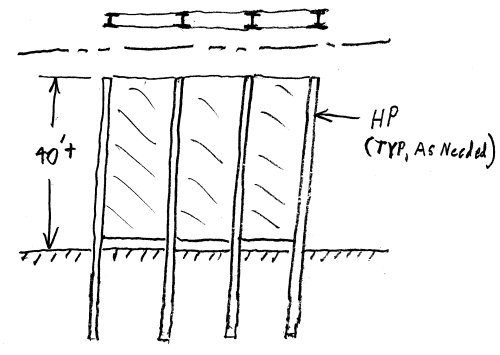

However, if you have no choice but to use a free standing wall (the title of your thread), piling can work, and likely be cost effective... even for 4 stories. When you see what even just the footing needed to resist wind loading overturning for a 4 story free standing wall will cost... revisit cantilever piling.
Thanks for the clarification Slideruleera, I understood now what you mean, a cantilever pile.
This is the best alternative to scare them a bit, haha. I understand your point on being cost effective. But the clients here hire cheapest contractors to do these kind of small wood framed residential buildings; and these contractors would not take a project involving driven piles or any other complexity. And they always ask for alternatives, so I am covered with this option!!!

Sleepless - I like that; use the piling concept to "scare" the client.
No matter what kind of free standing wall would be used, hard to imagine "cheap" contractors working on it 40'+ above the ground... they probably would not know how and certainly could not do it safely.

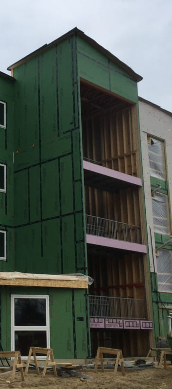

sleepless - I have transferred out of plane wind loads from my wood wall, as EOR, into the delegated design steel stair before. In the photo below, I had another wood wall on the other side, unlike your case. It sucks and you should avoid it at all costs, but it can be done if necessary. Be sure to detail your steel-to-wood connections to allow wood shrinkage.
