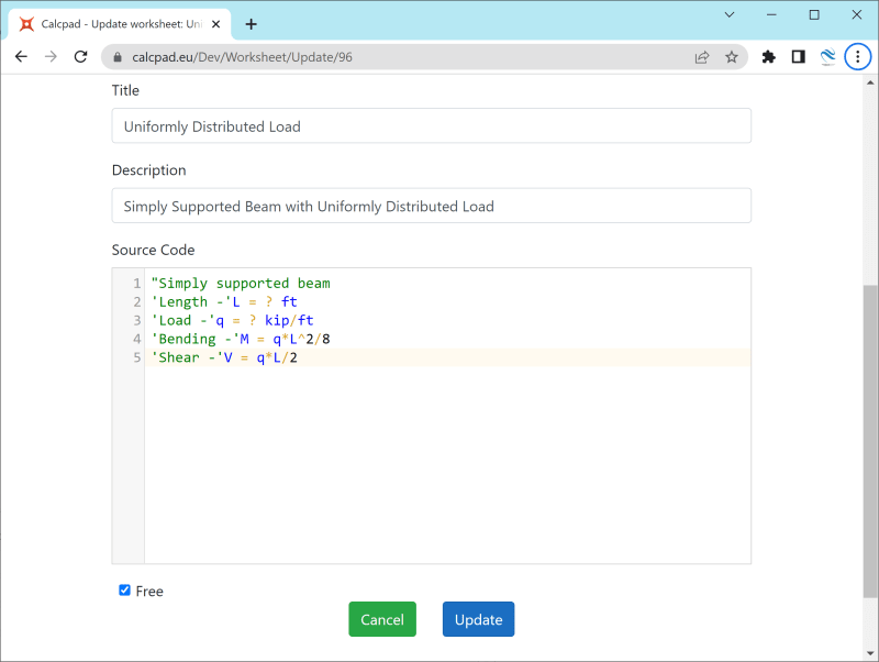

It was also the way I used to work before. Then it occurred to me to create a framework to handle all this stuff automatically. So what I do now is simply to write the code as it will look in the calculation notes. Wherever I need an input, I just put a question mark, e.g.:
"Simply supported beam
'Length -'L = ? ft
'Load -'q = ? kip/ft
'Bending -'M = q*L^2/8
'Shear -'V = q*L/2

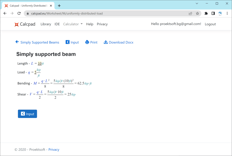

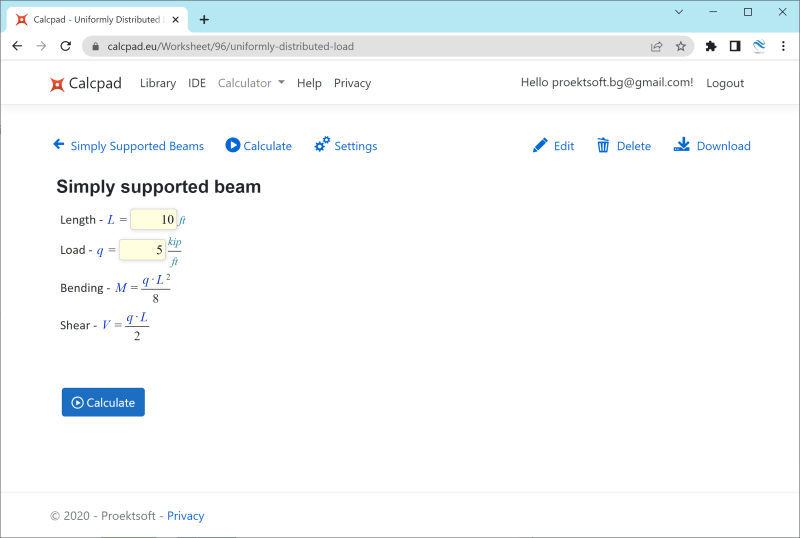

The platform automatically renders the input form, reads input values, parses the formulas, calculates the results and generates the report. And all that from this little script. It also natively supports units in formulas, as I mentioned before. The best thing is that all that 'programming decorations' are striped off the code, so you can really focus on the contents.

So you will need several times less code for the same thing than the classical approach and develop much faster. Also, you can involve other structural engineers to help that are not familiar with Python, JS, C#, etc.
The Calcpad platform itself is created with ASP.NET Core MVC and the code is in Github. It is designed for anyone that needs to create cloud/web structural apps. Even if not familiar with .NET, I can help to deploy and set up for use.
