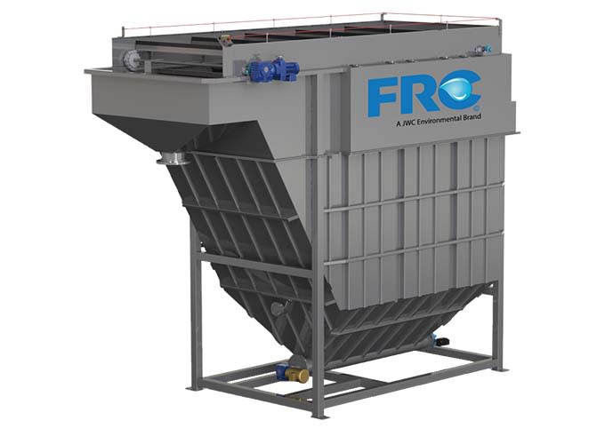

From the above comments, it would appear that you have never seen an ows. An ows looks something like what is pictured below:
Steam or electric tracing is installed on the outside of the tank as the wastewater fluid will foul anything submerged in the wastewater.

I would strongly suggest that you recommend to your client a modern ows installed on a flat concrete pad, off the ground and w/secondary containment.
Yes, I would go with what bimr is saying.
I haven't seen a concrete trough type API separator for decades and in my early days was responsible for replacing many failed units with the tilting plate single metal construction as bimr showed in the previous posts.
It would be feasible to insulate those and provide a reasonable level of heating to prevent freezing.
