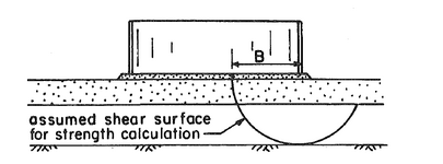

It says that punching shear, edge shear and base shear need to be verified.
I consider edge shear is what we call one-way shear.
Your guess is not correct. These are the soil failure types which shall be checked for design of storage tank foundation.
Short answer;
- Base shear failure : total shear failure of the entire tank foundation soil . Just look any foundation design book and allowable stress for spread footings,
- Edge shear failure : Local failure of a part of the tank perimeter together with some portion of the base. ( The following picture ).
- punching shear failure : failure of the supporting soil under the footing . Failure type C at the following figure.
Each failure type should be assesed by an experienced geotech eng.
These are basic knowledge and you could reach even just by searching the web.
Next time we are waiting more serious questions.
Short answer;
