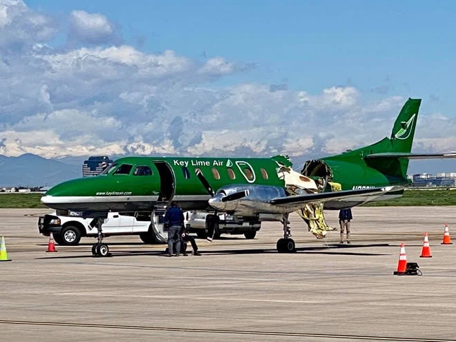

Did You see the photos of the cargo Metroliner, that experienced a mid-air collision very recently?

Wil, I worked a relatively modest freight / charter / air ambulance operator (~20 airframes, 6 types) that only had a design office, because they could spin it off the sister company's design office (Rotorcraft Mod shop). I liked the 227's they were cheap, performed well and atleast fuel wise economical (plus they gave us plenty of interesting work). The 227 made an interesting contrast to the F27's and J32 they operated, the later two looked like they would make their design life without really breaking a sweat (90,000 cycles) if one could just get the parts. While the 227's (35,000 cycle life) were flying crack repairs even at the mid life point, they were however a good demonstration of what does/doesn't work if pushing the edges of good design i.e. steel window frame doublers might work fine but prepared for non-inspectible corrosion issues if you let the paint get a bit poor!
As for the Key lime collision, the mind boggles with the fact that it managed to keep the tail, in the ones I supported the floor track stopped at the edge of the cargo door (as did the floor panels), otherwise I would have assumed that they were what was taking much of the loads no longer passing through the ceiling.
How "very" recently? The Key Lime sundeck mod was a year ago, May 13, 2021. I think that wasn't a hard landing situation (all humor solely due to everyone surviving - whistling past the graveyard.)
Imagine if the stress guy who did the analysis looked at the rest of the team and said "I told you the floor needed to be that strong and you all said it could be lighter."

For those of You wondering about the 'Key Lime and Cirrus' mid-air mishap... The SA227 [cargo flight?] and a Cirrus [training flight] collided near a Colorado airport. The SA227 continued-on-to make an 'uneventful emergency landing'. The Cirrus had to use the CAPS [force deployed parachute] system to save the pilots. I always wondered how such brightly painted aircraft [lime green, obviously] could NOT have been seen by the Cirrus pilots. Oh Well... blessing of no casualties.
