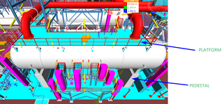

When calculating Fundamental Time Period for Platform on horizontal vessel and Foundation Pedestal, Ta, using Chapter 12.8, ASCE 7-10.
Ta=Ct*Hn^x
For Platform, Hn is height from grating to grout(top of pedestal), and seismic force acts at platform beam level.
For Pedestal, Hn is height from grout to grade, seismic force acts at half Hn.
Is it correct or not?
The horizontal tank can be assumed rigid non building structure on short rigid piers .
You may calculate the base shear for the tank and anchorage with formula V=0.33*SDS*I*W assuming R=3.0 and for supporting structure (for piers ) 0.3*SDS*I*Wt
Use the formula (13.3-1) for the platform.
