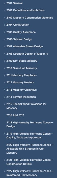

This is what the Florida Building Code looks like, take the Masonry chapter as an example. After you get through all the 'regular' sections you see adopted from the parent code "IBC", you move onto those sections specific to Miami-Dade and Broward counties (HVHZ):

2121 is the "Construction Details" section of the masonry chapter of the FBC. Since nearly everything down there needs to be built with masonry, it's the Florida version of the 'conventional light frame construction' section of the wood chapter for everyone else. Prescriptive details that, when used on a 'typical' and 'simple' structure will provide a resilient structure capable of resisting the high velocity wind loads to be expected. This is where your full height masonry wall is required.
2122 is the "Go be an Engineer" section of the masonry chapter.
2023 FBC 2122.2.1 said:
Section 2121 shall not apply where design and construction are in accordance with the provisions of this section.
So, if you're using TMS 402 (The Masonry Code) to design the structure according to the actual, anticipated loads...you can do as you please (more or less).
