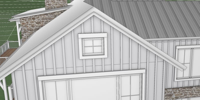

When you have prefab gable trusses, do you always use a dropped gable (last truss at the end, inside the wall, a few inches shorter to support the rake framing)? Or do you use gable shaped wall balloon framing? If you do use a dropped gable, how do you treat the big window below it. Do you assume the big window take the load from the rake framing? Or do you just put minimal header because technically the dropped gable is taking the load.

Thanks phamENG. This is snow country. I always do ladder framing over wall/dropped gable. Most of my projects are mostly stick framing but recently expanded my region where prefab trusses are more common. So if you have gable end truss sitting on the wall, and you have a window that is quite large, how do you design the header? Assume header will take the roof ladder framing? Or assume the end gable will take the load above the window? I just dont want to specify LVL headers unless I have to.

Another question, what if the gable end has window into the attic? Forget about putting a truss in the wall? Too much coordination?
Coordination isn't the issue, it's having a place to put the window. The end truss has everything turned flat so it's only 1.5" deep. Not enough to really mount a window in. And if it's livable space, not enough to insulate, either. In that case, I'd put a stud wall.

We can put a rough opening in a gable if there's a false window in it.
