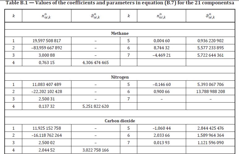

One note regarding the source document for the model constants. The ones in the original paper are of course correct (Wagner & al.).
Reason I am mentionning this, is that I found unnaccuracies in the constants published in ISO 20765 Part 2 (edit: 2015).
More specifically, it concerns Appendix B, Table B1 of the standard. I do not know if this has been revised in the newest version of the standard (I guess there is was an update in 2018). This is also a note of caution to others in case they are working with these standards.
I just searched a bit more in my archive about this point.
It seems at least there is one mismatch I spotted.
It is for CO2 when conparing between original paper (GERG2004) and ISO standard 20765-Part II (GERG expansion 2004 -> 2008 there was no supposed change regarding the coefficients for CO2 in Table B-1). So here it is:
ISO20765 Part2
Original Paper
Edit: same type of mistmatch for Nitrogen too...
