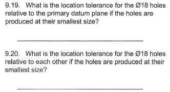

Hello everyone, could you help me by guiding me in solving the following 2 questions, I am currently studying the subject of GDTS on my own on the internet and I have no one to advise me with my questions
Thanks to everyone for your support!
What is the location tolerance for the 18 holes relative to each other if the holes if the holes are produced at their smallest size?
Calculate the inner and outer boundaries of the 18 holes relative to each others

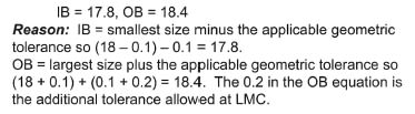

I would say 0.1 respectively 17.8/18.4 for the OP's question. Would be nice if someone double check my numbers.
Snapshot from the Solution for the ones who need to know the answer.

So what is the correct answer of
"What is the location tolerance for the 18 holes relative to each other if the holes if the holes are produced at their smallest size?"
0.4 or 0.1 or neither?
I am confused.
It would come from the lower portion of that composite FCF (the 0.1); what ASME calls the Feature-Relating Tolerance Zone Framework.

Too bad, its my mistake, snapshot the wrong place, here is correct one.
